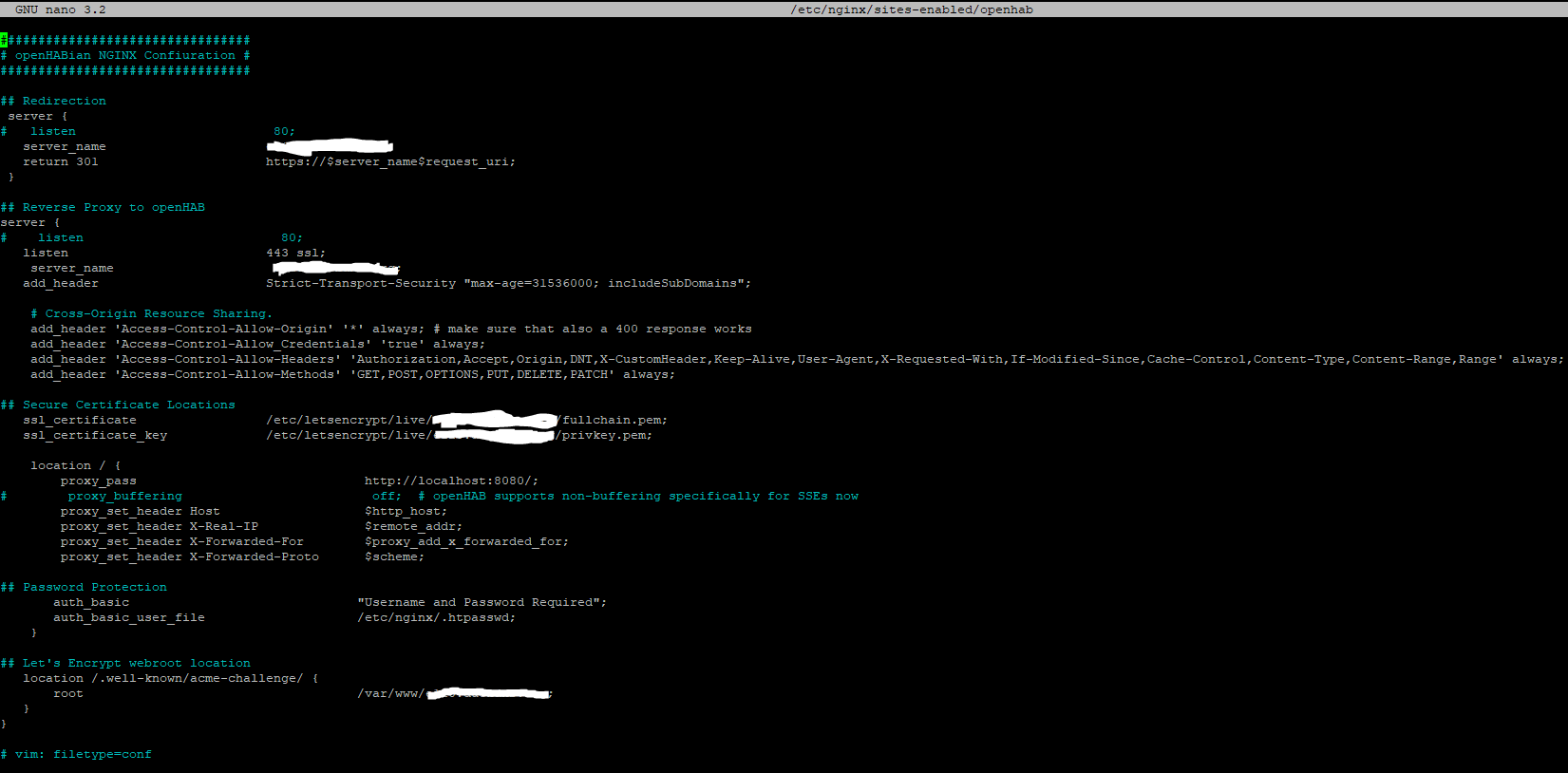

Here you can see my config for nginx:
(Domain is marked out)
I’m not sure where I went wrong… All the paths seem to add up.
