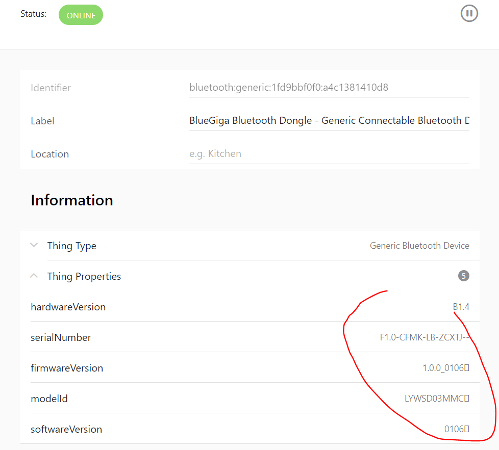

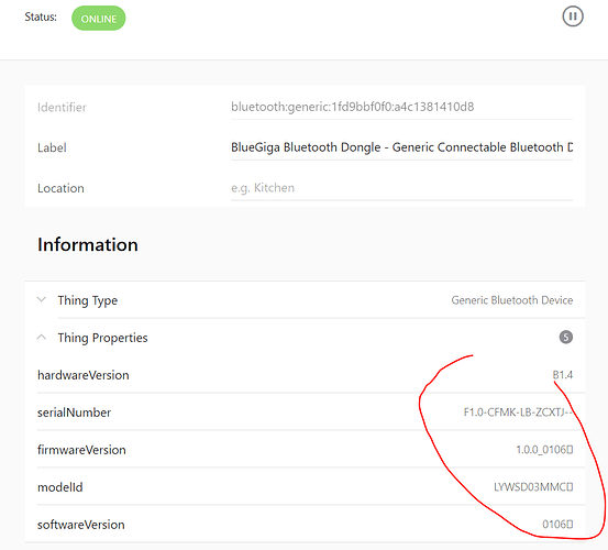

So I brought my zoo of BLE devices in proximity to my OH3 test system as offered in the past:
The devices were discovered and added to the inbox. One out of them even shows at least some of the GATT’s as thing properties:
This is the square thermometer (“Xiaomi Mijia Bluetooth Thermometer 2 LYWSD03MMC”).
Is it all what can be expected yet? Or should some of the devices “known” by @vkolotov s 3rd party binding get more attributes decoded yet?

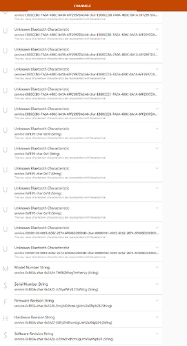

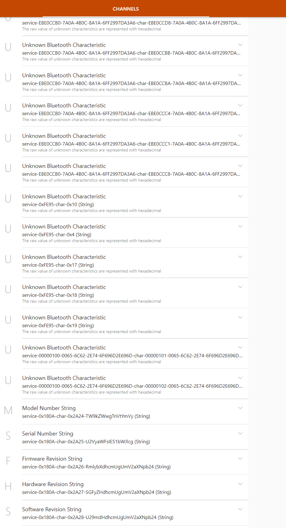

Did you have a look at the channel tab of the thing as well? That would be more interesting.
Yes, I did :wink:
Beside the “decoded” attributes which were used for the thing properties, a bunch of "unknown Bluetooth characteristic"s are there:

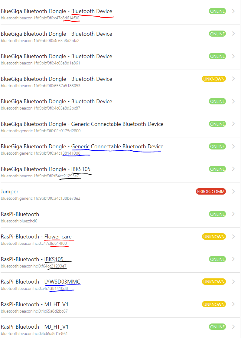

When activating the onboard Bluetooth of the RasPi in addition to the BlueGiga dongle, then the scan results are different between the two Bluetooth adaptors (Bluez vs. BlueGiga):
The bluez/RasPi Bluetooth does not show any generic device but shows the correct device/model names in thing label which is not the case for BlueGiga (just the iBKS-beacon is recognized and labeled accordingly).
Again: My question is still wether this is all which should work yet or if there should be more decoded already?

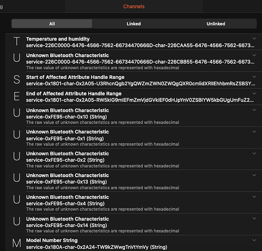

After playing some hours with the new official Bluetooth binding I don’t get any consistent GATT results from my BLE devices (beacons, thermometers, flower care, oxymeter), neither via Bluez nor BlueGiga.
I’m wondering if it is too early for expecting almost similar functional range as we had with the “3rd party binding” in the past… :thinking:
@cpmeister May I ask you directly, up to what extent Vlad’s work made it into the current snapshot? Could you elaborate a bit, what could work already and what should not be expected to work yet?
What do you mean by this? Are updates sporadic or do the gatt channels simply not show up for your device? I think I should note, based on the screen shots that you sent, that beacon and generic devices are completely different in the bluetooth binding. Beacon devices will only ever have an rssi channel. Generic devices will have the gatt channels. If you only discover your device as a beacon then it means that there was some kind of connection problem with the device so you might have to rerun discovery.

I do test with some devices which are just beacons (“iBKS105” broadcasting as iBeacon and Eddystone at the same time) and “generic” devices broadcasting GATT’s. Some of the generic devices (but not all!) were previously recognized and decoded by Vlad’s binding.
What I see is that my devices have been discovered - but almost all just as beacons without characteristics/channels other than RSSI. Only surprising exception is the …
… which was not known to Vlad’s binding formerly. For this device, a bunch of GATT’s were discovered but just the standard attributes have been decoded correctly. The interesting channels holding the sensor values of temperature and humidity are missing. But I think it makes sense, since this device was not covered by Vlad’s characteristics database yet. Reversing the usage/meaning of the characteristics still needs to be done. Maybe I should play with the “unknown characterics” channels to find out the relevant (temperature, humidity) and how to decode them…

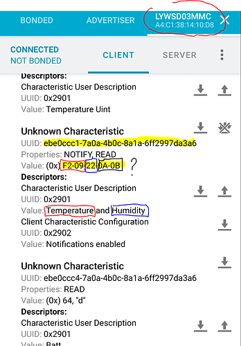

@cpmeister I’ve probably reversed successfully the unknown temperature/humidity characteristic of the LYWSD03MMC:
I’ve connected with nRF Connect to the thermometer and observed the unknown generic characteristics and compared them with the values shown on the display of the device.
The guessed decoding is as this
UUID: ebe0ccc1-7a0a-4b0c-8a1a-6ff2997da3a6
Value: 0x TT-TT-HH-UU-UU
          34-12-12-12-34
Where
T1-T2 = first byte of temp value
T3-T4 = second byte of temp value
H1-H2 = humidity value
U1-U4 = unknown
Example from screenshot above:
Temperature: 0x09F2 = 2549 = 24,49 degree celsius (device display “24,4”)
Humidity: 0x22 = 34 = 34% relative humidity (device display “34”)
I’ve observed changes in temp/hum on the display and compared it with the reported values while having the above decoding “algorithm” applied and got matching result.
Is such information sufficient to add them to the characteristics database?
What else do you need?

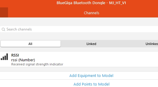

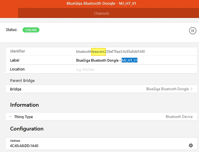

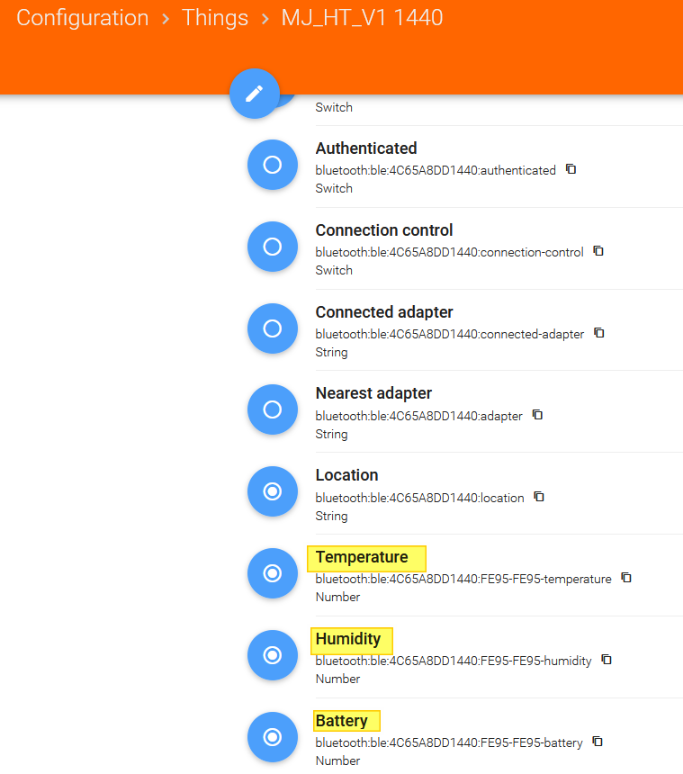

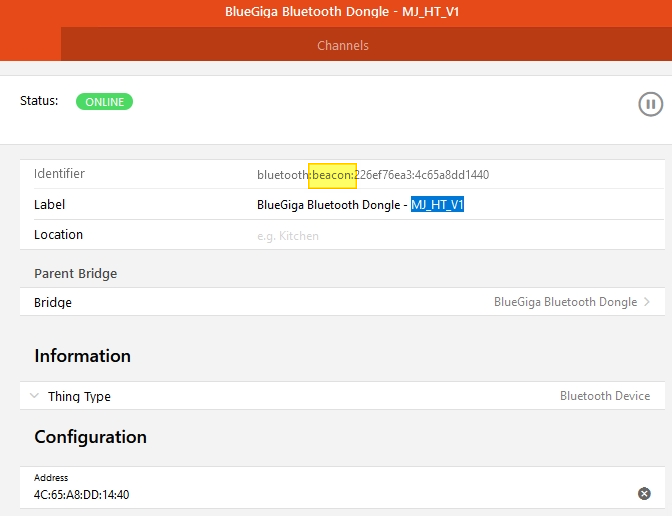

I am not sure if I understand this correctly but this does not seem to be true for all devices. I am using the Xiaomi Mijia Bluetooth Temperature and Humidity Sensors (MJ_HT_V1). These devices work with Vlad’s binding and I still use them with his binding (running an old version of OH2.5M3 on a Raspi and connected to my main OH instance via MQTT). Within Vlad’s binding these devices expose channels like temperature, humidity and battery level:
When I try to use the device with the new official bluetooth binding (OH3 Snapshot 2028), they are discovered as beacons…
and only expose one channel for RSSI:
This device is definitely part of Vlad’s database so there still seem to be issues with the binding.
