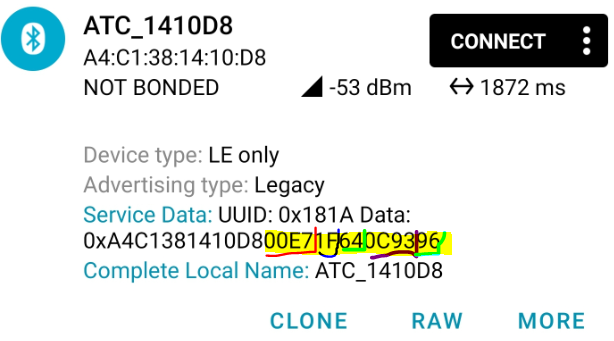

Fortunately Tukks shared the information about a custom firmware for the LYWSD03MMC
… which turns that device into a “broadcasting mode” too, meaning it may behave similar to the round Xiaomi thermometer: Just broadcasting it’s data on UUID 0x181A.
I gave it a try: I’ve flashed one of my devices and can receive now the data as descibed by the developer, see:
The “encoding” is documented by the developer too, so it should be easy for us to get the readings out of broadcast through a transformation or similar:
The format is like this:
Byte 5-10 mac in correct order
Byte 11-12 Temperature in int16
Byte 13 Humidity in percent
Byte 14 Battery in percent
Byte 15-16 Battery in mV uint16_t
Byte 17 frame packet counter
