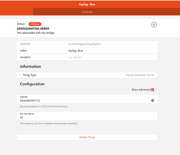

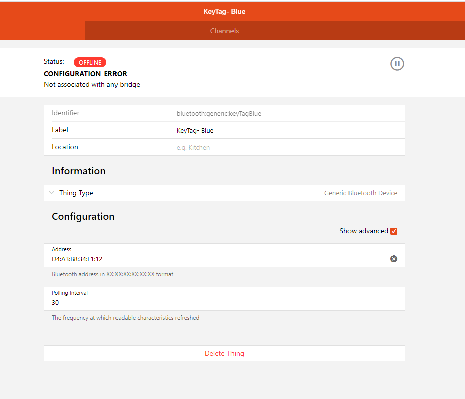

Hi all,
First time I’m trying to connect a Bluetooth device to my system and I’m having a bit trouble, I think I’m missing something.
I’m running OH 3.0.1 on RPi4 (with openhabian).
I have an iTAG device (on of those anti lost beacons) and from what I read it’s supposed to implement GATT protocol, so I tried adding it as the generic device that exposes GATT. The one described in this link:
First I defined a bridge thing, which is the BlueZ interface because I don’t have any BT stick at the moment.
For some reason I can’t find using the scan button so I tried adding it manually.
I can confirm that both the bridge is working properly because I successfully discovered and added my smartphone as a thing, and also that the iTAG is working because I successfully interacted with it through several BLE apps on my smartphone.
So I extracted its MAC from on of those BLE apps and entered in the thing configuration page. (MainUI).
After saving the thing status is OFFLINE with CONFIGURATION_ERROR saying it’s not associated with any bridge.
But the configuration page doesn’t have the field for selecting the bridge (see screenshot):
So my questions are:
  1. In case it’s a bug with the binding, where should I post it so it could be checked out?
  2. Is there a way to manually add the bridge configuration?
  3. Has anyone succeeded to work with those BLE tags on OH3 with the BT binding and can share about the process?
Thank you all for the time and effort.

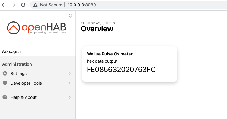

I’m totally new to OH, my apologies if this isn’t the thread to ask this question.
I’ve successfully connected my pulse oximeter with the Bluetooth Binding and Generic Bluetooth Device extension, and I’m receiving data from it. However the data is in a hex format with extra info. I’ve been able to figure out which parts of the string I need.
How do I go about parsing the hex string in OpenHab or Bluetooth Binding, in order to display the correct parts of the string in decimal form on my dashboard?
Thanks, love the binding - implementing was pretty intuitive
I think you can use javascript transformation on your item link via a link profile.
Doing so, you can use your (hex-) string input channel converted by javascript to some of your item’s data.
If you have to extract more than one value out of the provided hex string, you simply can create multiple item links to the same string channel with different transformation profiles.
Hope that helps :wink:
@curlyel thank you! Exactly what I needed.
