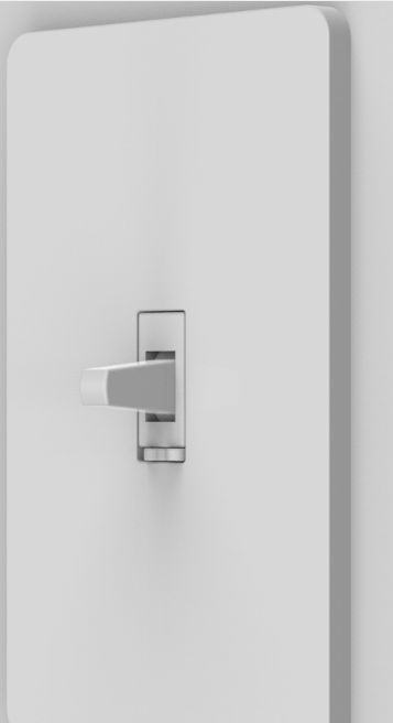

OK, here in the US, I replaced one of my switches with a Zooz Z-Wave switch powered from the mains. It works without OpenHAB or any other software. My second standard switch for that light works too. Using the Z-Wave switch allows me to use motion sensors to automatically turn on the light and then turn it off so it is not left burning, wasting electricity.
The one I got even looks like a standard Us toggle wall switch.

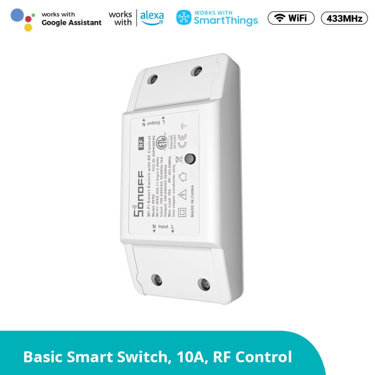

What about a sonoff T1?
You can flash Tasmota on it. It will connect to wifi direct. No hub needed.
Set the MQTT in the switch and bob’s your uncle, wifi “dumb” switch.
Actually tasmota can do much more but it can be plain dumb too.

Yes that the sonoff T1 - https://sonoff.tech/product/wifi-smart-wall-swithes/tx-series
