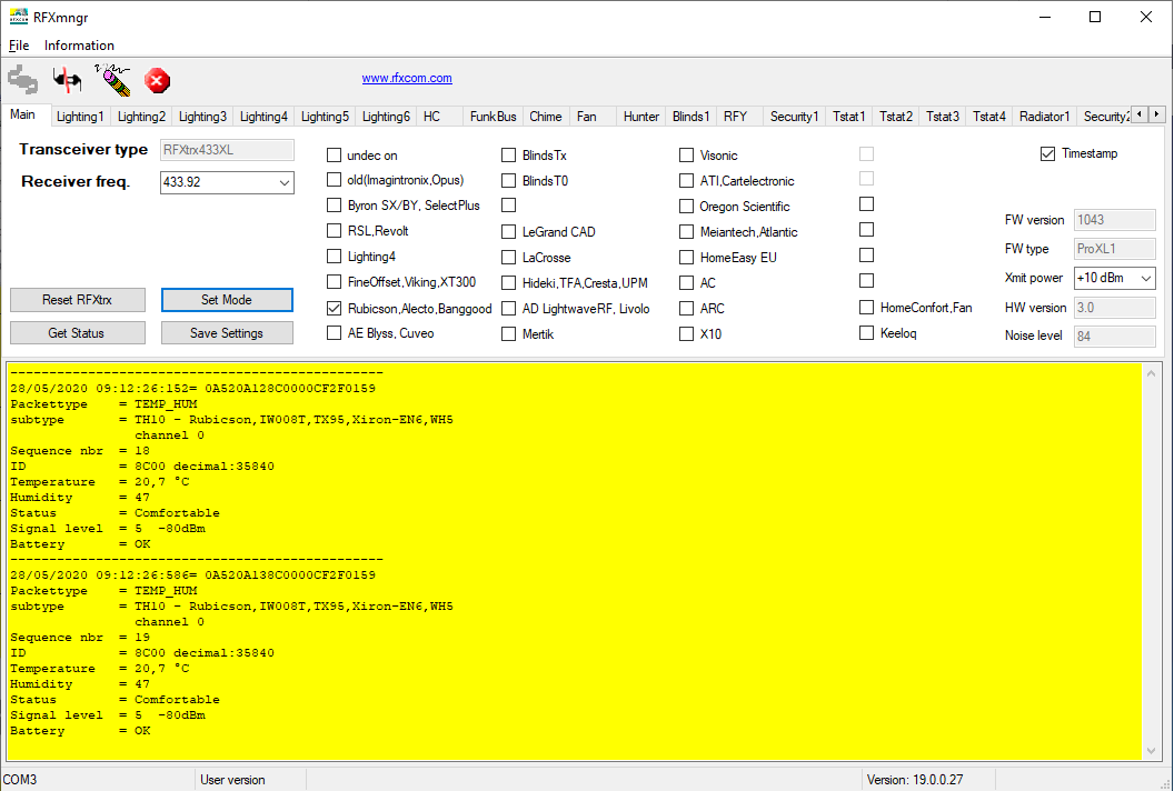

I’ve made some progress, and managed to get some response in rfxmngr.

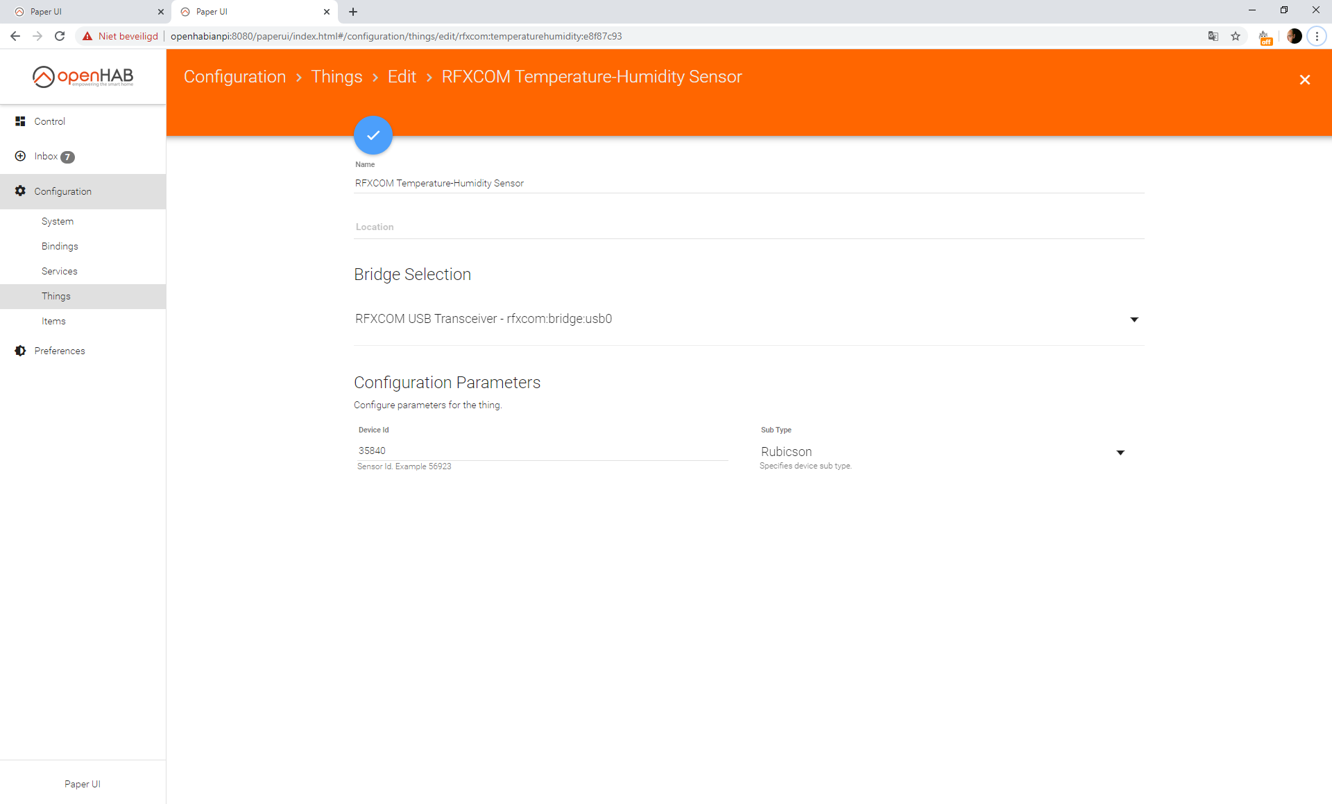

But when I manually configure this in openHab, I get no readings at all..any ideas?

I’ve installed the latest firmware and at first it looked like it was supported by rfxcom as you can see in the screenshot. But as temperatures got higher, I got no readings anymore in rfxmngr. Only undecoded, the messages came through. I’m using openhabian on rbp3, so I also found out that discovery of things in openhab with rfxcom isn’t working because of an ARM-limitation of some library. But even if I manually defined a thing with the ID I initially got from rfxmngr, no readings appeared in openhab. So in the end, it looks like i’m stuck…
O.k., so nothing has changed since my last attempt with RFXcom and GT-WT-01/02.
