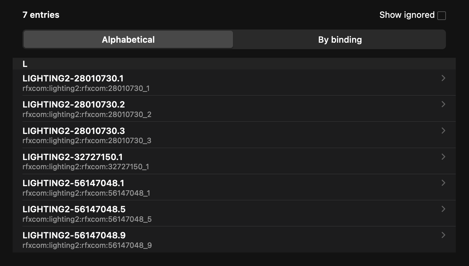

I’m using the RFXtrxXL 433MHz transmitter (www.rfxcom.com)
Installed is OH3 3.2.0 and the rfxcom binding.
There are several things discovered and put in the inbox.
However, I have no clue at all what these devices are. My first guess is something that is transmitted via Philips HUE (because of the “LIGHTING2” stuff). If that is possible at all.
Is there any way to trace what these entries are?
Thanks in advance.
Andre
These may belong to one of your neighbors
Disable the AC protocol in the RFXtrx to stop receiving these.
In fact, enable only the protocols in the RFXtrx you need to receive.
