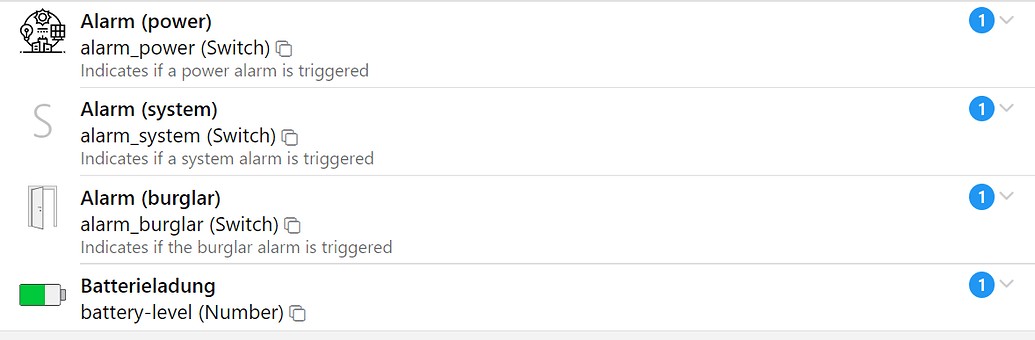

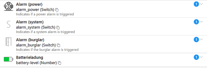

I can (kind of) include it, but don’t get updates from the channels below,.
(and at the end of the inclusion the led indicates an error - namely red flashing LED).

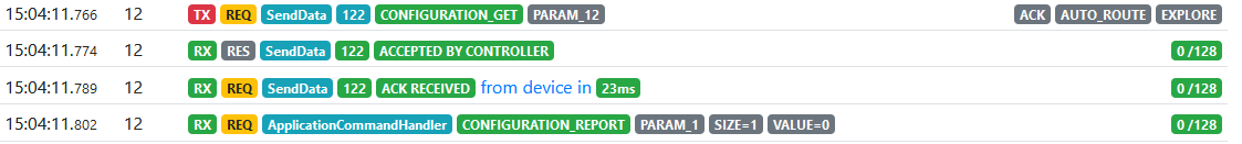

Check log and device definition in Z-Wave database:
Looks like there isn’t a parameter #12 … Confirmed by Z-Wave JS Config DB Browser
I strongly suspect a mismatch between Z-Wave parameter definitions in Z-Wave database/official device documentation/DUT. Not sure whether fixing this mismatch will fix OP’s problem.
The log posted by above shows the device not responding to several “GET” requests during initialization, so the channels do not get initial values. As I do not have ring devices I can’t say if this is a feature, bug or a faulty device. My guess after a quick scan of the manual is that the device may expect secure inclusion and the default in the binding for motion devices is without security. The zwave binding only has S0 security (which might work-and can be activated on the controller UI page), but the manual mentions S2 security which is not supported by the binding.
If you do not have the device, my advice is there are plenty of motion detectors that work well with OH. Beside the initialization issue above, the parameters the device returns during initialization do not match the documentation. (as noted by @Ap15e). I also noticed the channels shown above are not the correct ones for motion detection, so it is very doubtful this is working (IMO).
