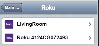

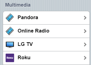

Some screenshots of the generated interface below.
