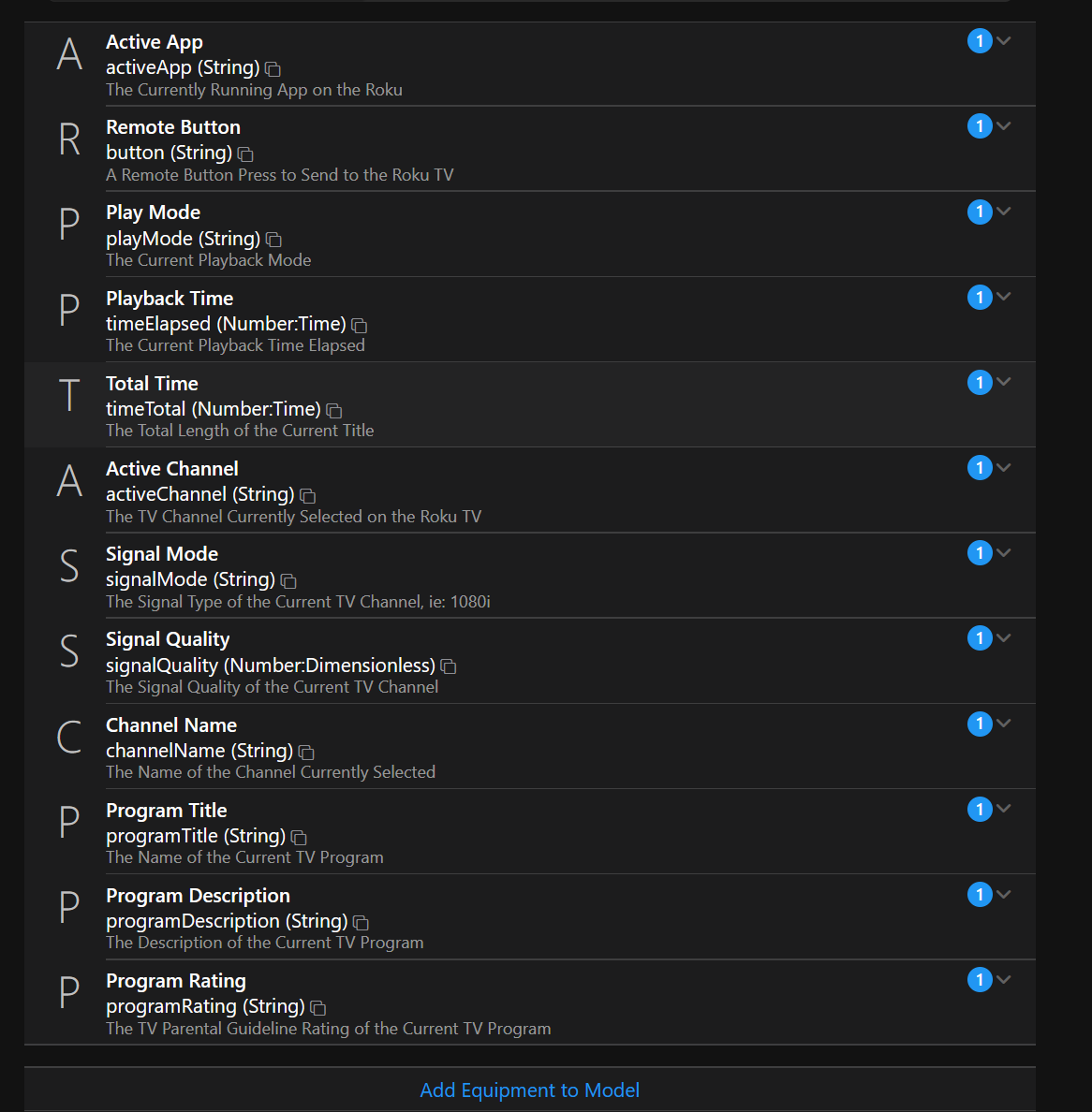

So i am running the 4.1 version of the binding with a thing type of roku_tv that is discovered via the binding.
However, when i add the thing the additional power related channels of “power” and powerState" are not being added.
Here is a picture of the channels which are added.

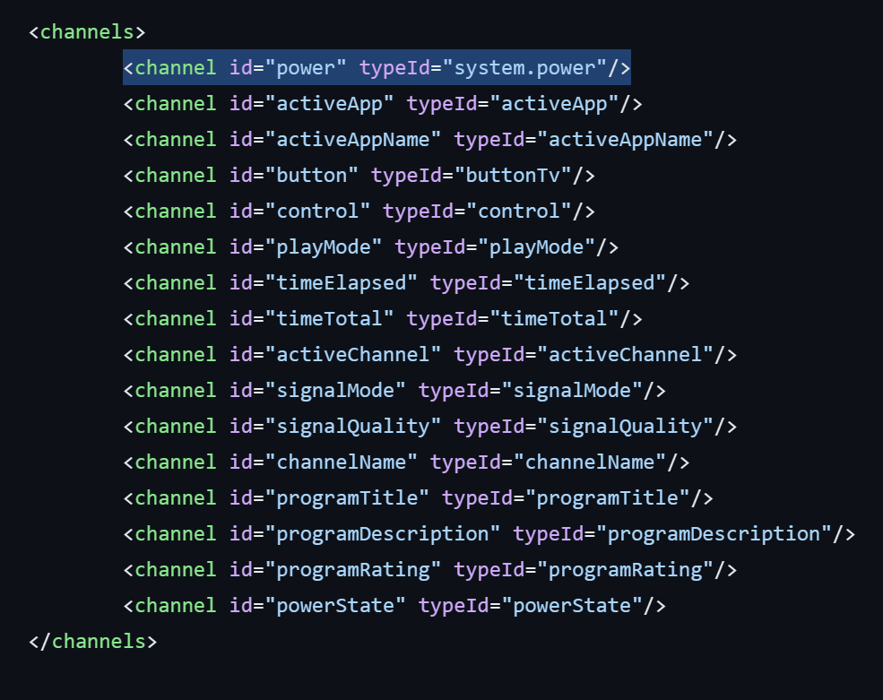

It looks like from the github on the current version of the binding that these channels should be there.

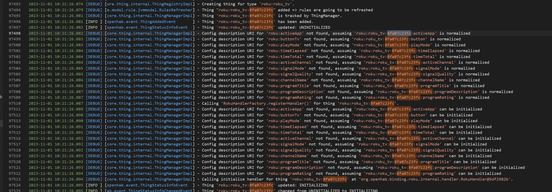

Ok so i did some more digging and turned on the DEBUG logs for the org.openhab and created a new test thing for a roku_tv type. It looks to me like it is not using the new URI descriptions to create the channels and is using a version from an older version of the binding?
Is there something i need to change/cache i need to clear to have the new URI descriptions be used? Or is this perhaps an error in the code for the binding?
