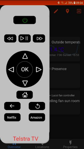

I just wanted a basic remote for my Telstra TV box that happens to be a Roku controller and I didn’t need to have the http binding or any feedback from the Roku.
What I did was create a rule, an item and modified a widget that someone else had created. (Thanks to whoever created it as I cannot find it again to see who did it)
Below is what it looks like on my phone.
Anyway I will put it here in case someone else wants to do it. I am sure there is a better way but this actually works.
The rule to receive the remote commands

The widget code
uid: Remote roku
tags: []
props:
  parameters:
    - context: item
      description: Select the remote you wish to use at an equipment item level
      label: Select Equipment
      required: true
      type: TEXT
  parameterGroups: []
timestamp: Jun 17, 2021, 4:16:55 PM

The item I created is called rokuitem and it is just a simple string item.
THe IP address of the Roku is hard coded in the rule. You need to change that to your IP adress.
Maybe someone else can use this?
