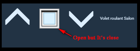

I connected my FGR-223 to openhab and I use IFTTT to speak to google to open and close my roller shutter. It’s work good
First, I tried to find a nice widget but i didn’t find it !
If you have one, it interests me
So I put a custom widgets on Habpanel and my problem is that when my rollershutter open, the widget is closed and when it’s close, my widget is open !
That’s a problem
The state goes wrong and I do not know how to recover the good state
And I tried to put the percentage on the widget and It doesn’t work
If you have a solution, i will be very interessed
Thx a lot for your help
There’s an option on the blinds_control channel to invert behavior. Use PaperUI to change that.
Thx It’s working.
I just had to invert percentage value
