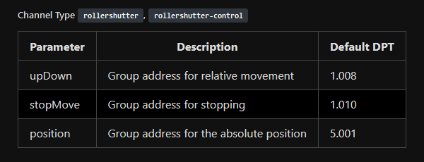

For the start/stop (stopmove) openhab uses a different DPT by default, if I read correctly:
grafik
The ETS states 1.008. So who is right and should I change the DPT in the ETS or expect openhab to be able to accept 1.008, if I set it?
Answer to myself: change the ETS. For the actual actions it does not make a difference since it is 0/1 anyway, just for the display on the group monitor, 10.010 is more precise.
