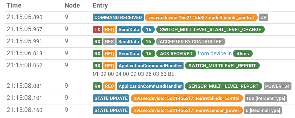

Hi @chris,
i noticed that the items is getting changed to 100% after the UP command, ist that correct?
cause if i remember right in OH 2.1 it was 0%
Node 9 is the on i tested it in this case.

If it used to be 0, and now it’s 100, have you checked to see if there’s an invert option set on the channel?
yes checked, and none of the channels is inverted.
if i use a percentage, with the slider on habpanel for the roller shutter, and put it on 0 or 100 the roller shutter is behaving as expected.
Looking at the log, the binding doesn’t set the value to 0 - only 100% -:
It sends the start level change command, then queries the state which comes back as 100%, and the binding is then setting the state to 100%. I don’t see a problem from this log at least and I don’t see where the 0% is coming from, but it doesn’t seem to be the binding.
correct, the part i try to understand is:
  1. what should be send to device with the Up command ? 0 or 100
  2. why could i see the below in the logs if i send the UP command from habpanel or basic UI.
    where its first getting changed to 0 but the back to 100?
2018-07-01 21:15:05.864 [ome.event.ItemCommandEvent] - Item 'S_LR_Shutter1_S' received command UP
2018-07-01 21:15:05.893 [GroupItemStateChangedEvent] - C_LR_Shutter_S changed from 100 to 0 through S_LR_Shutter1_S
2018-07-01 21:15:05.917 [GroupItemStateChangedEvent] - R_LR_Shutter_S changed from 100 to 0 through C_LR_Shutter_S
2018-07-01 21:15:05.935 [vent.ItemStateChangedEvent] - S_LR_Shutter1_S changed from 100 to 0
2018-07-01 21:15:05.957 [GroupItemStateChangedEvent] - H_Shutter_S changed from 100 to 0 through R_LR_Shutter_S
2018-07-01 21:15:05.965 [GroupItemStateChangedEvent] - H_Shutter_S changed from 100 to 0 through S_LR_Shutter1_S
2018-07-01 21:15:08.119 [GroupItemStateChangedEvent] - R_LR_Shutter_S changed from 0 to 100 through C_LR_Shutter_S
2018-07-01 21:15:08.122 [GroupItemStateChangedEvent] - H_Shutter_S changed from 0 to 100 through S_LR_Shutter1_S
2018-07-01 21:15:08.124 [GroupItemStateChangedEvent] - C_LR_Shutter_S changed from 0 to 100 through S_LR_Shutter1_S
2018-07-01 21:15:08.127 [vent.ItemStateChangedEvent] - S_LR_Shutter1_S changed from 0 to 100
just one other thing, im not sure if something changed or my understanding is wrong.
if i use % for a roller shutter in combination with the fibaro module, is 100% fully closed or fully open?
before it was fully closed.
I don’t know - it might depend on how you have it wired. The binding doesn’t set 0 or 100 - it sends a “Start Move” command - the device itself will then interpret that however it likes.
As I said earlier, I don’t know - it’s not coming from the binding based on the log you provided at least.
A long time ago I reported similar issues while using the invert percent option and those were solved via database update for the FGR222:
So deleting the thing and readding it again could be a solution.
