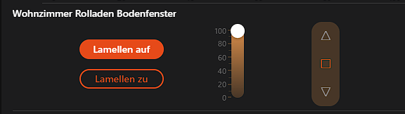

Like so? I also use shelly 2.5 for my blinds (venetian and not venetian types):
Here is the widget code (used in lists):

Here are the rules for switching the blinds between open and closed (not up or down). As the blinds do not support separate channels for positioning the shutter slats, I counted the time used to change between the positions using only up and down and it works fine:
