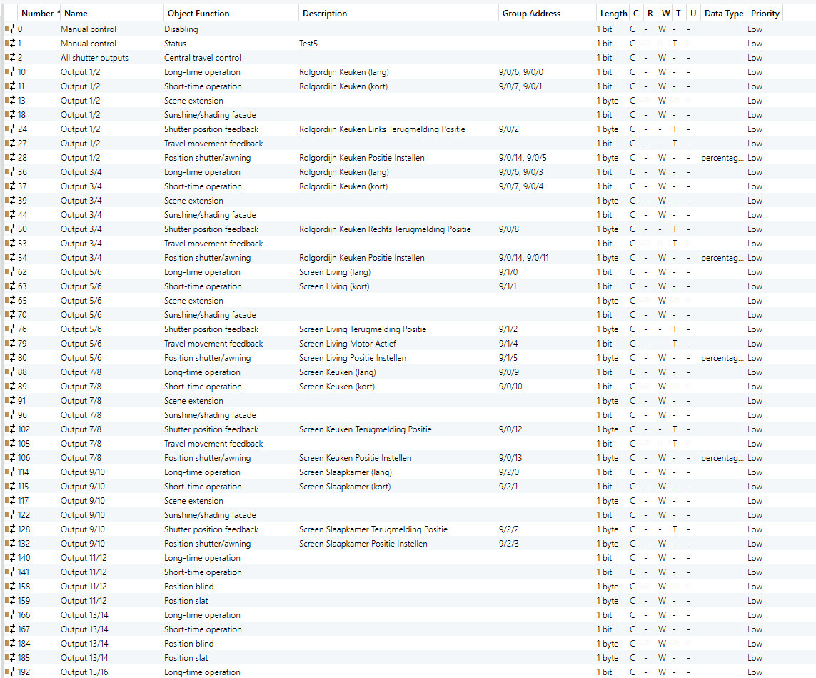

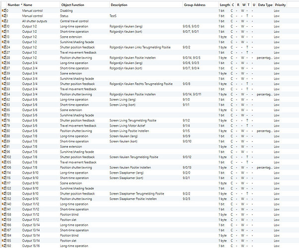

Hi Dries,
thanks for dropping by! Could you please paste a screenshot of your GAs in the ETS? Would be great. I’m a bit confused by your 9/1/5 “set Position (%)” and 9/1/2 “Position Status (%)”.
Perhaps it’s “Position Jalousie / position” and “Rückmeldung Jalousie / Position Feedback”, but I’m not sure. For comparision, my GAs look like this:
(please note: I changed since the GA 4/1/3 from above post to 4/1/6)
Sure buddy. See below:
Let me know if you need anything else.
