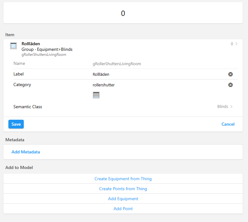

OK, I changed it as you described, but I don’t have the rollershutter control in the UI for the group item, when I do it this way.
Group item code now:

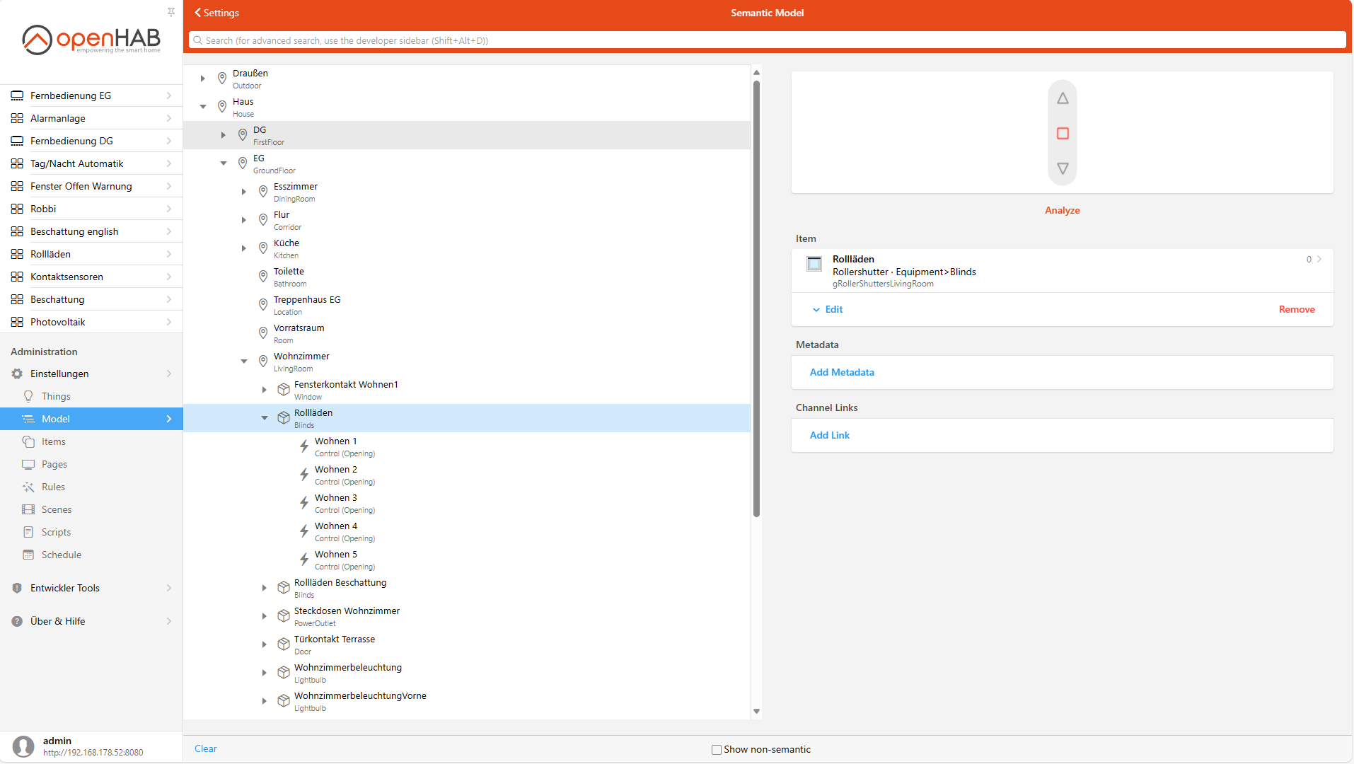

MainUI makes a best guess based on available information as to what sort of control/widget to show for each Item type. But it can’t always get it right. That’s why there is the “Default Standalone Widget” and “Default List Item Widget” metadata. There you can define exactly how you want the widget to appear.
In general, because an Equipment in the semantic model is made up of Point Items and it’s the Point Items that have the controls and the state, MainUI doesn’t show any controls for an Equipment Group no matter the Group type.

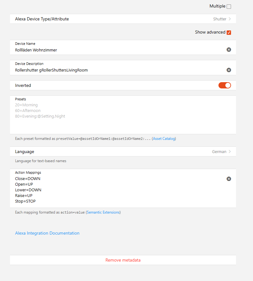

I see in the logs, that my items did not receive the command “UP” or “DOWN”, but 0 or 100.
Seems to be caused by the action mapping in the Alexa metadata.

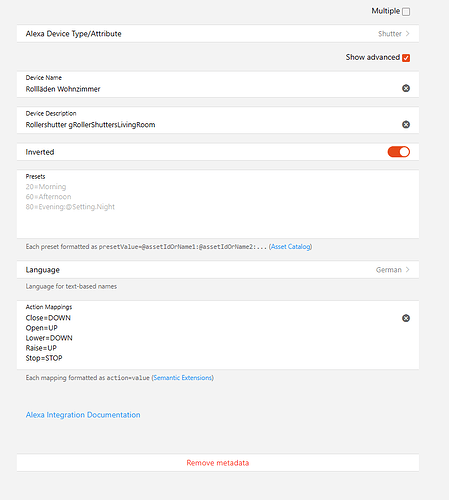

For the single rollershutter items, it looks like this:
Close=DOWN
Open=UP
Lower=DOWN
Raise=UP
Stop=STOP

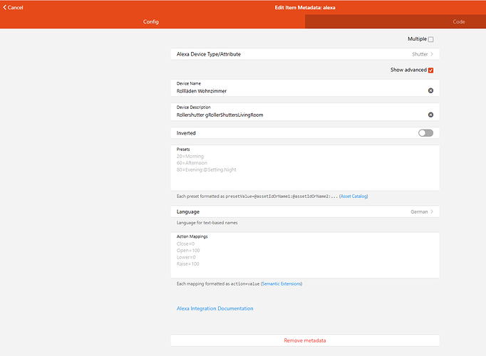

For the rollershutter group item, it looks like this:
Close=0
Open=100
Lower=0
Raise=100
Unfortunately, you cannot edit the action mappings for the groupt item :frowning:
edit 2: My mistake: You can edit the action mappings for the group item. The box showed the default values in a way that looked “disabled” to me. But the box is actually empty and can be overriden.

Sorry my mistake:
The action mappings looked disabled to me, but it is not. It’s actually only showing the defaults. If you start editing, the box is empty.
I will change the action mappings and see if that fixes the problem. :slight_smile:

You shouldn’t have to configure the action mappings. What you are seeing in MainUI is just a placeholder example. The skill has defined default settings based on the item (group)type per the documentation.
It would be helpful if you could provide the exact utterances you are using for the voice requests. You may want to refer to this post for more information on that topic.

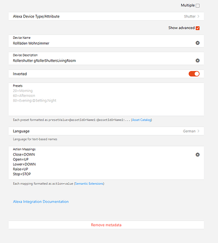

Well, for a rollershutter item I get a default avtion mapping like
but for the group item, I get
But my rollershutter items cannot handle values like 0 or 100, I handle the commands UP, DOWN, STOP in the rules of the items.
When I say “Rollläden Esszimmer hoch”, it does not work.
When I say “Rolläden Esszimmer auf”, it does work.
There is a difference between defaults, as you highlighted in your first screenshot, which you can edit when you select the field and a placeholder example which is just an indication on how to configure a given parameter and isn’t representative of its actual default value. Anyway, this is only a display issue since the skill will use the documented defaults.
Now, as you may have noticed, there is indeed a bug in MainUI with the Alexa metadata not displaying the defaults for group type based items. I have already submitted a fix for this one.
