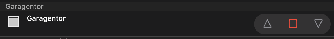

However if I press the up/down buttons in openhab the value changes immediately to 100 or to 0 and no up/down command gets send to the knx bus.

As to what UI I’m refering to,I use just the default MainUI, specifically the autogenerated buttons / rollershutter control by the semantic model.
