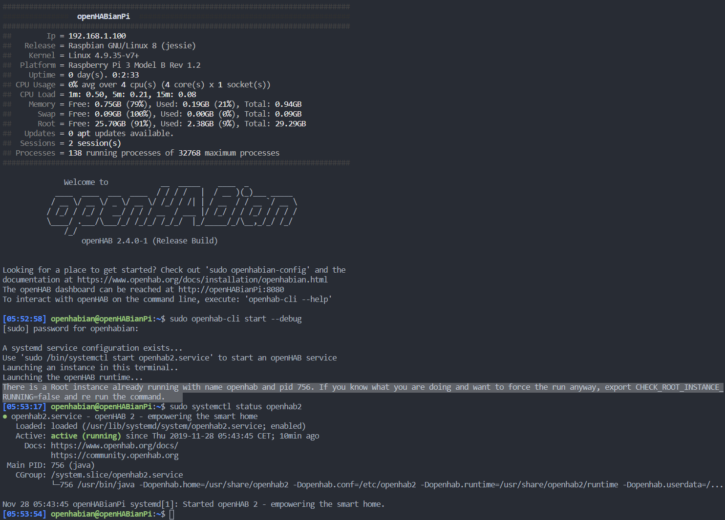

Root instance already running - OH won't start
i just wanted to get Homekit back to work.
i stopped OH and cleaned cache (openhab-cli clean-cache) and now i cant get my OH running. PLEASE HELP
root instance already running with name openhab ? how to fix this ?
i already rebooted several times, nothing helps and i am a noob :frowning:

openHABian automatically starts openHAB on boot via systemd, you mustn’t start that manually.
Manual startup will spit errors when it tries to use some of the same ressources as the running instance does (such as a portnumber).

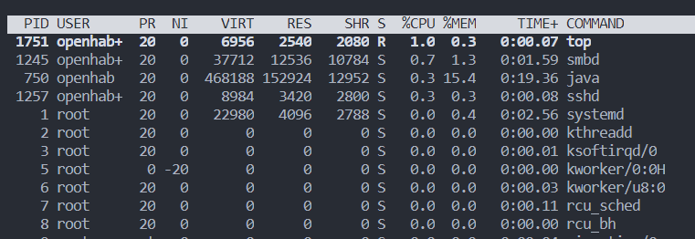

Use top at the command line to show everything running on system. Looks like OH pid is 756 but need to confirm that then use kill pid 756 to stop the instance. After that reboot and see what happens.
Edit: You may need to clean the cache again.

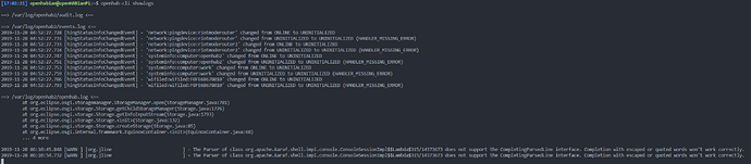

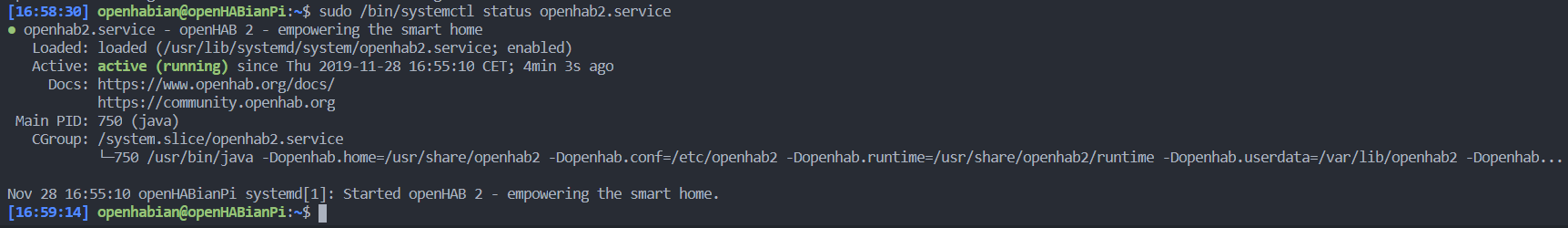

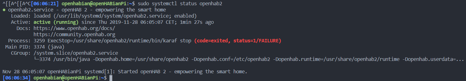

i’ve done that, now i get this status and my log does nothing
Use sudo systemctl stop openhab2
sudo openhab-cli clean cache
sudo reboot

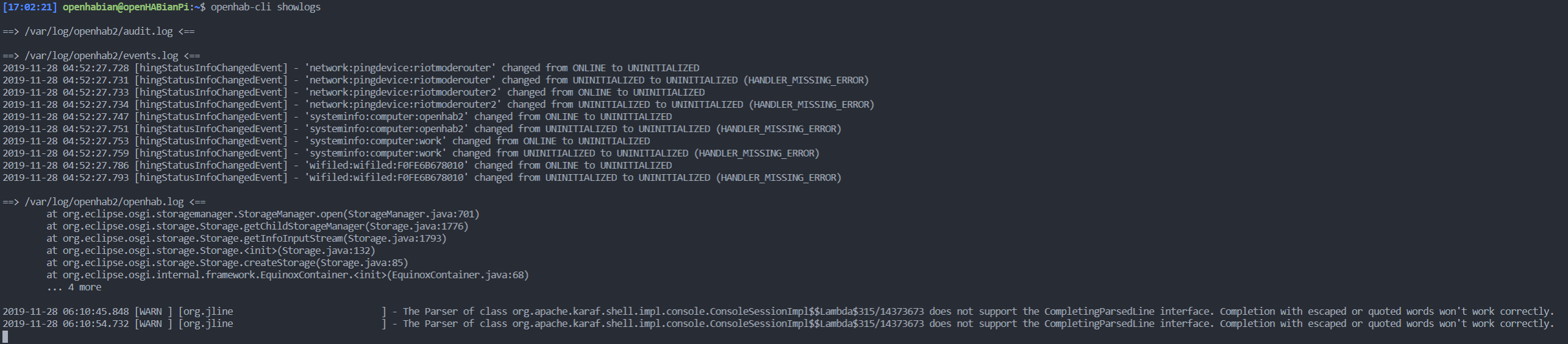

Also open a browser with fronttail so you can watch the logs as OH starts up.
