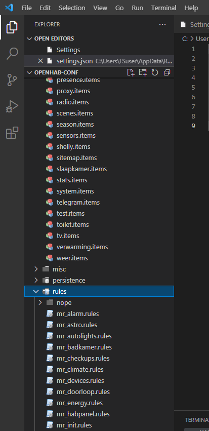

Can you give us a screenshot/overview of how your config folder looks like?
How many different files, how many rules files, how many files opened parallel?
I cannot screenshot it because it doesnt fit in my screen. It’s a lot, but at the time of enabling LSP, there where no files opened in VSC.
I have 31 item files, 36 rules files and 16 thing files.

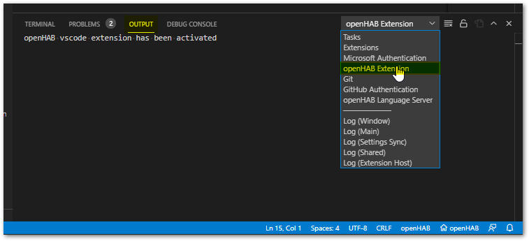

Can you check of the openHAB extension output gives any messages?

openhab extentsion doesn’t give any complaints:
openHAB vscode extension has been activated
