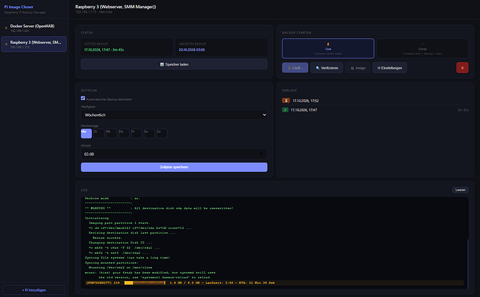

If you’re running openHAB on a Raspberry Pi 24/7, losing your SD card means losing everything — configs, rules, persistence data. I built a small self-hosted web tool to automate SD card backups via SSH.
How it works:
You insert a backup SD card into the Pi (via USB adapter), and the tool SSHs in, runs rpi-clone, and automatically fixes cmdline.txt and fstab with the correct PARTUUID — so the backup card boots directly without any manual steps.
Features:
  • Web UI to manage multiple Raspberry Pis
  • Weekly automated schedules (cron-based)
  • Live progress display during backup
  • Boot partition auto-fix after every clone
  • SSH keepalive — works reliably even for large backups (2+ hours)
  • Encrypted SSH credentials
  • Docker / Portainer ready
Stack: Python · FastAPI · Paramiko · APScheduler · SQLite · Docker
Requirements on the Pi:
  • SSH enabled
  • rpi-clone installed
  • A backup SD card connected via USB adapter
GitHub: GitHub - pierrecinema/rpi-image-cloner: Web-based Raspberry Pi SD card backup tool via SSH — with auto boot-fix, weekly schedules and Docker support · GitHub
Full setup guide with step-by-step instructions is in the README. Happy to answer questions!

Yes, but openHAB requires a separate Raspberry Pi. Many applications run very stably on my Docker container. With my tool, you don’t need a PC to perform the backup, as it uses the Raspberry Pi’s USB port. Just swap the SD cards.
