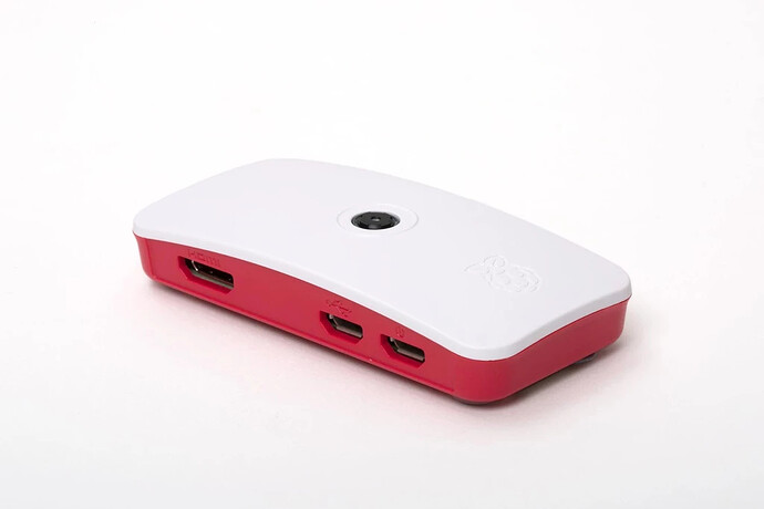

  2. RPI Zero+RPI Camera (small housing) - have 3 sets

I have a Raspicam installed in my garage and I have the following experience:
  • It’s kind of flakey
  • It has horrible low light
  • Relatively low framerate even when connected to an RPi 3.
