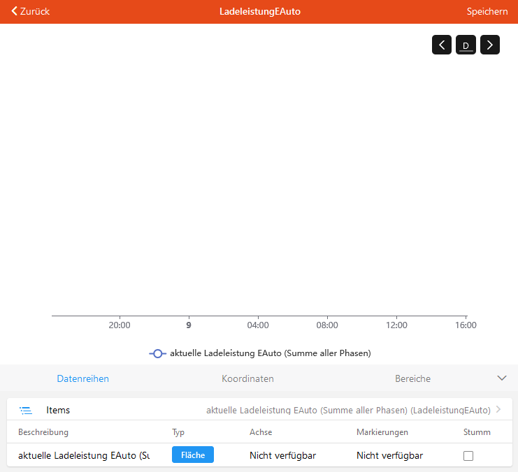

If I try to graph items (“Analyze” e.g.) it works - except for one specific item I found. It isn’t soo different, but with others it works and with that it doesn’t.
item’s configuration:
Number:Power maxLadeleistungEAuto "max. AC-Ladeleistung an der Wallbox" <energy> (EV,EnergieEinstellungen) ["Car"] { stateDescription=" "[ pattern="%.0f kW"] }
The graph is just empty (sorry, german)
(other items with the same configuration show up in their graphs!?)
As you can see, there’s no graph here - but! if i request some information from the API, the information is there?

So, why does it not work here?
I already deleted the /srv/openhab-userdata/persistence/rrd4j/LadeleistungEAuto.rrd
and it was built anew - with just the same result?
What is wrong with the item to not show the graph here?
