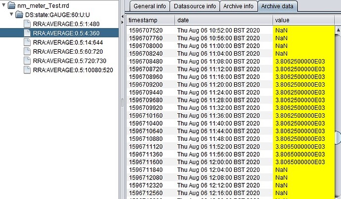

Because the system is not 24/7, I have gaps in the persisted data, naturally enough. Here’s a sample from rrdInspector, 2nd archive where it’s been consolidated to every 4 minutes.
No surprises so far.

I don’t really know how historicState() decides which archives to look in, but tested here with a target time that is not in the first every-minute archive, but is in the second 4-minute archive.
Requesting historicData() for 11:59 gives me the expected object with state 3806.75, and timestamp 11:56
I say expected, because what I would expect is for searching for 11:59 exactly to “fail”, but then look for preceding data instead.
Likewise, seeking for 12:02 returns data stamped 12;00
Requesting historicState() for 12:10 returns null.
That’s not what I expect. As I understand it, if there is no record at the specified time instant, historicState() should grope back in time until it finds a record, making the assumption that data persisted until the given time.
In short, return the next-oldest data.
It’s arguable that the NaN records do represent “the next-oldest data”.
But those NaN records have been created, synthesized, by the rrd4j aggregation process. No data was actually recorded for those times at all.
