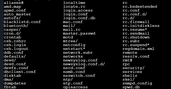

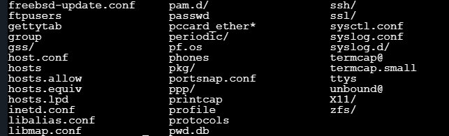

Hi Udo,
i used the pkg installer, but there is no openHAB2 folder or similar. I tried all folders, which are in the /etc directory, but didn´t have any success (see files attached).
The rc.d looked the most like a conf-folder, but didn´t include the files I searched for
I’m pretty sure that openHAB is installed in another folder, including all configurations.
