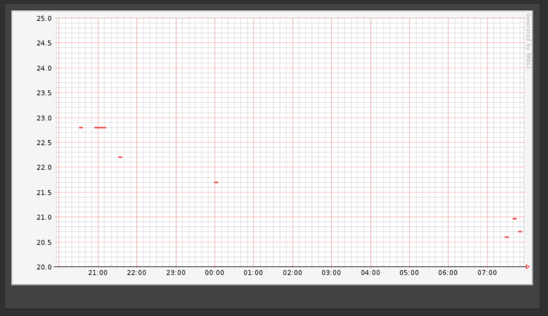

I am using rrd4j persistence at it seems to work more or less. However, it doesn’t save the values as I want it to for the two items I defined (the two items belong to two different physical devices).
My config looks like this:

But the charts I create look like this
more or less the same for humidity…
Does someone know what’s wrong with my config?
Thank you!
Rrd4j needs a strategy “every minute” in order to function correctly.
I’ll second @opus
According to the docs rrd4j MUST include an everyMinute strategy
See:
https://www.openhab.org/addons/persistence/rrd4j/#example
OK, thank you very much. Actually I’ve seen that but I thought this strategy has to be defined and not used. That is why I defined it without using it… :sweat_smile:
I have changed the docs to highlight the fact that the everyMinute strategy MUST be used
Don’t worry, you are not the first one to ask this question
When you get stuck, please search the forum, before asking a new question. Your problem has probably been answered before.
Good luck
