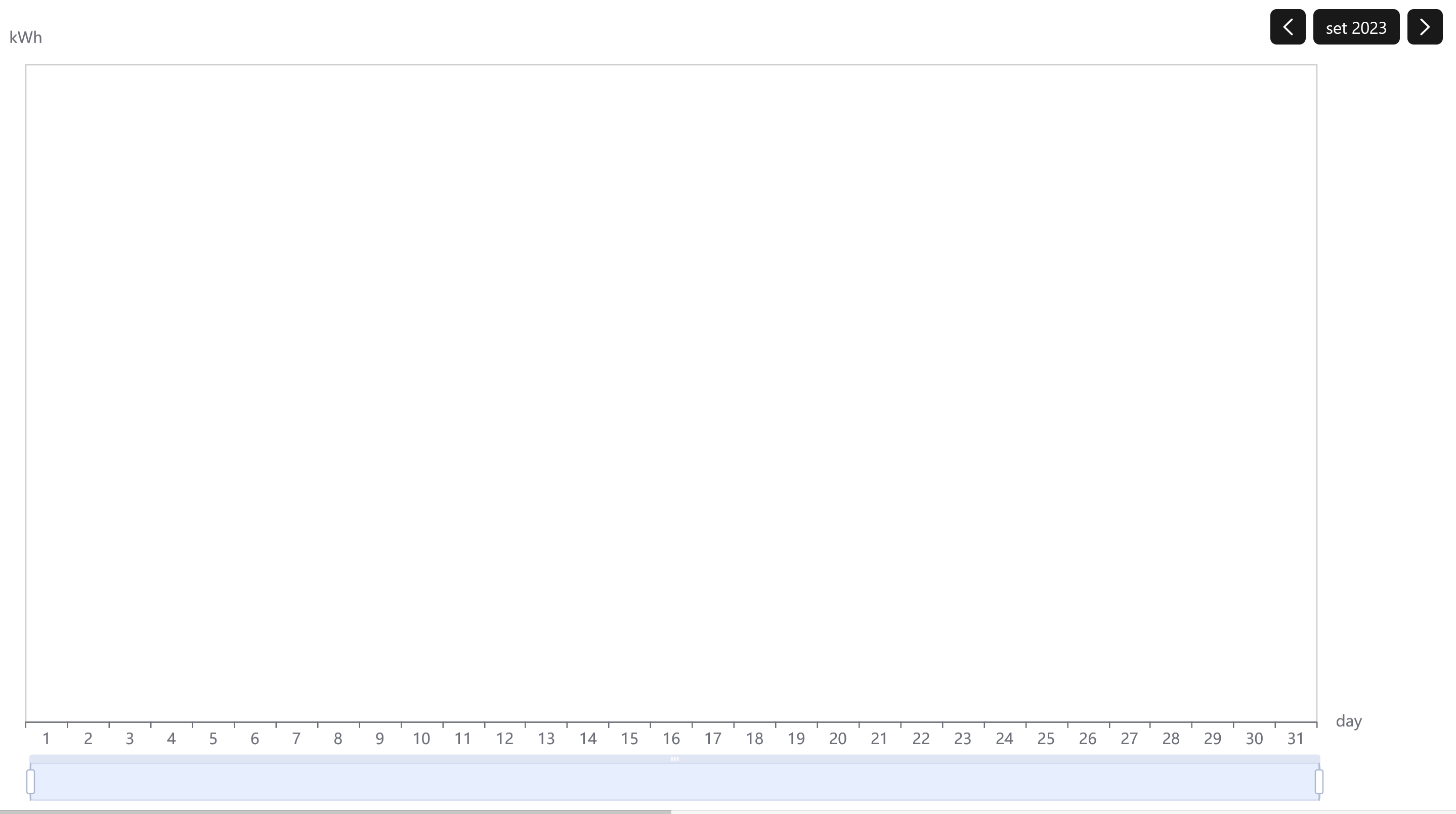

I’ve been using rrd4j to log data for various items in my solar power system, and everything was working smoothly until last week. I was able to view all the monthly data on my graphs, but recently, the data seems to have mysteriously disappeared. As a result, my charts are empty, and I can’t figure out what went wrong.
I’m wondering if anyone else has encountered a similar issue with rrd4j. It’s frustrating because I’ve been relying on these graphs to monitor my system’s performance over time, and suddenly, they’re blank.
I’ve attached some screenshots to illustrate what I’m experiencing. Here’s an example: [insert screenshot link]

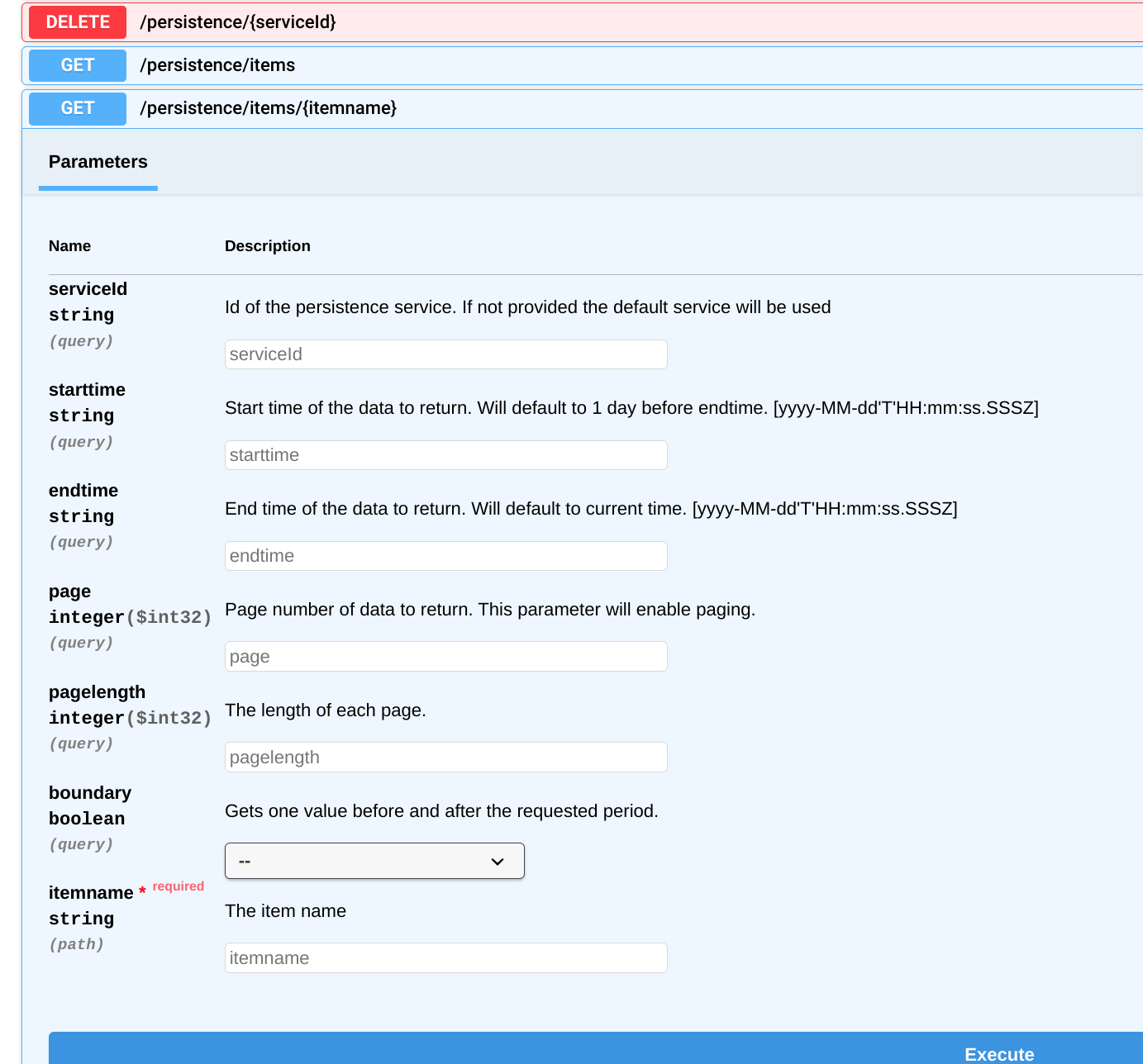

You can confirm by using the API Explorer to query for what is in the database for the dates where the graph isn’t working.

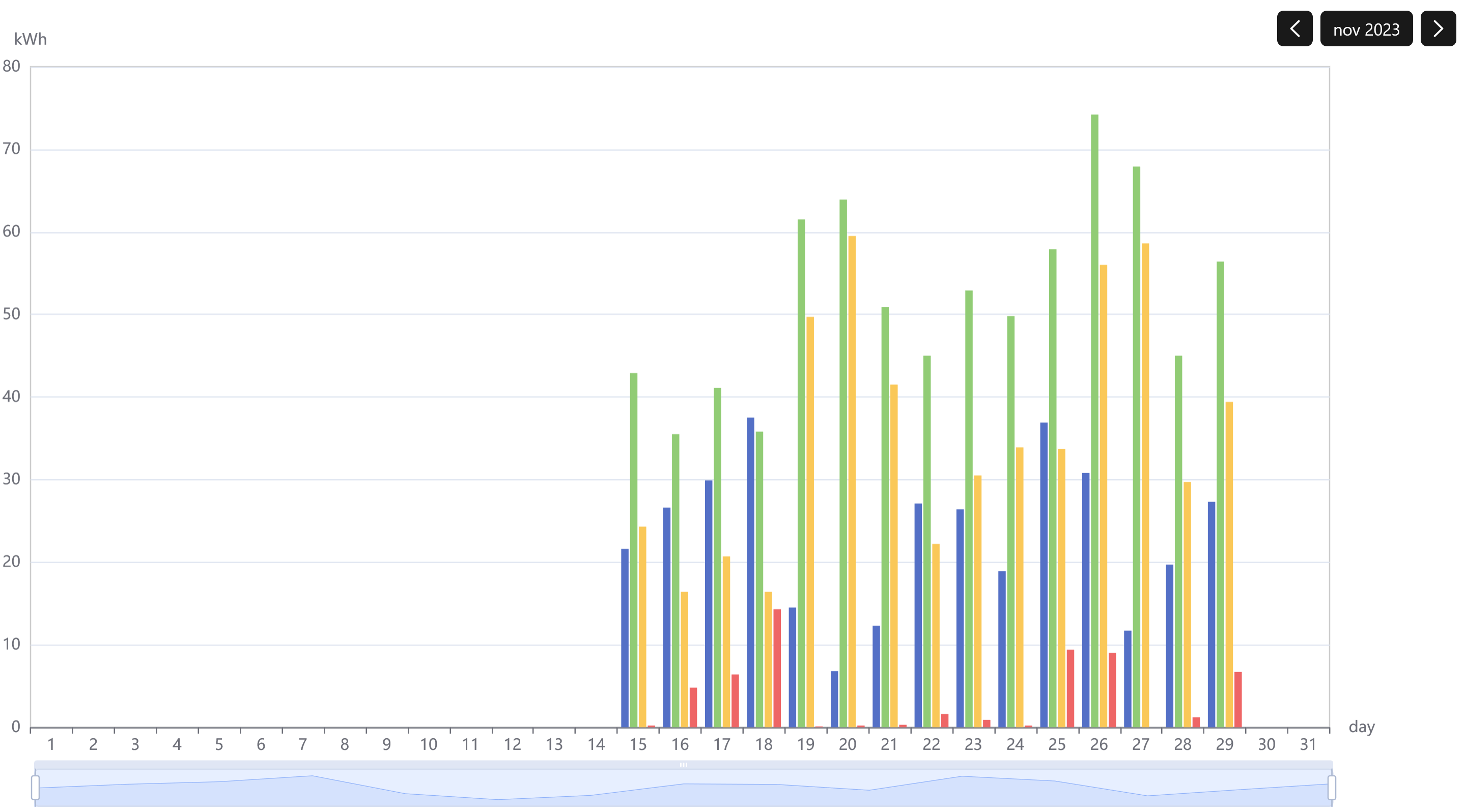

Can you give me an example how to query the item in the exact period? and another thing is that every month I see the last day fullfilled…this from the starting:

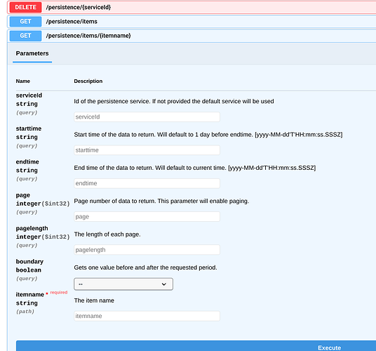

Go to Developer Tools → API Explorer → Scroll down to “persistence”
@rlkoshak ok I did this query:
http://192.168.0.200:8080/rest/persistence/items/DeyeModbusProdDaily?starttime=2023-11-06T00%3A00%3A00.000Z
So starting from 6 November but first set of result start from 15 November (so like in the previous graph). Openhab is running on a raspberry, never restarted.
