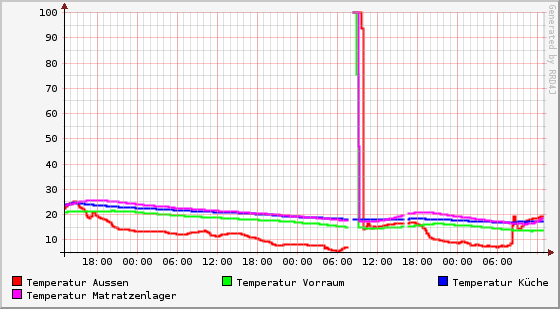

I encountered an error in my Mi Smart Binding, which resulted in temperatures in 100°C:
now I have two issues:
