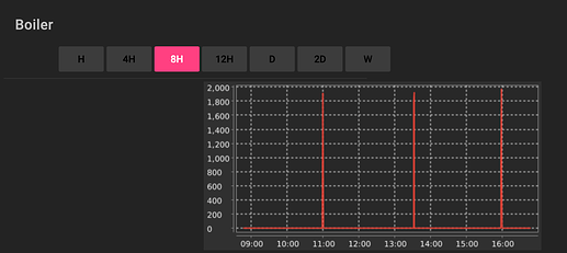

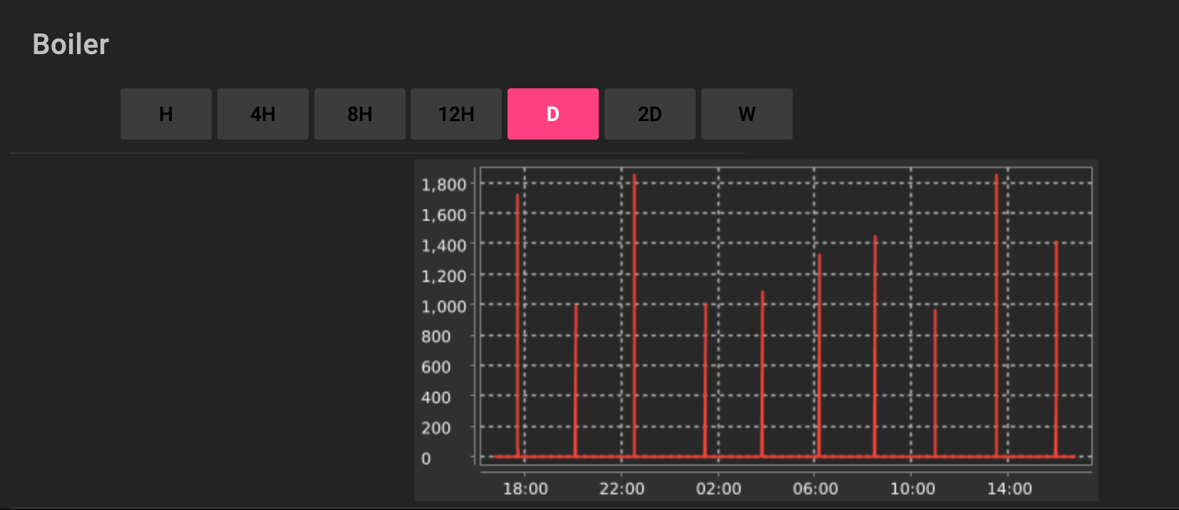

I’m playing around with some custom configuration on rrdj4.
I have a Item which represents energy consumption in watts. The device I’m looking at is a boiler which uses power every some hours for a short period of time.

This configurations put this data in the rrd archive:
rest JSON:
{“time”:1567334940000,“state”:“0.0”},
{“time”:1567335000000,“state”:“1672.7499999999998”},
{“time”:1567335060000,“state”:“0.0”}
So new entry every 60 seconds. Looks like the default configuration.
