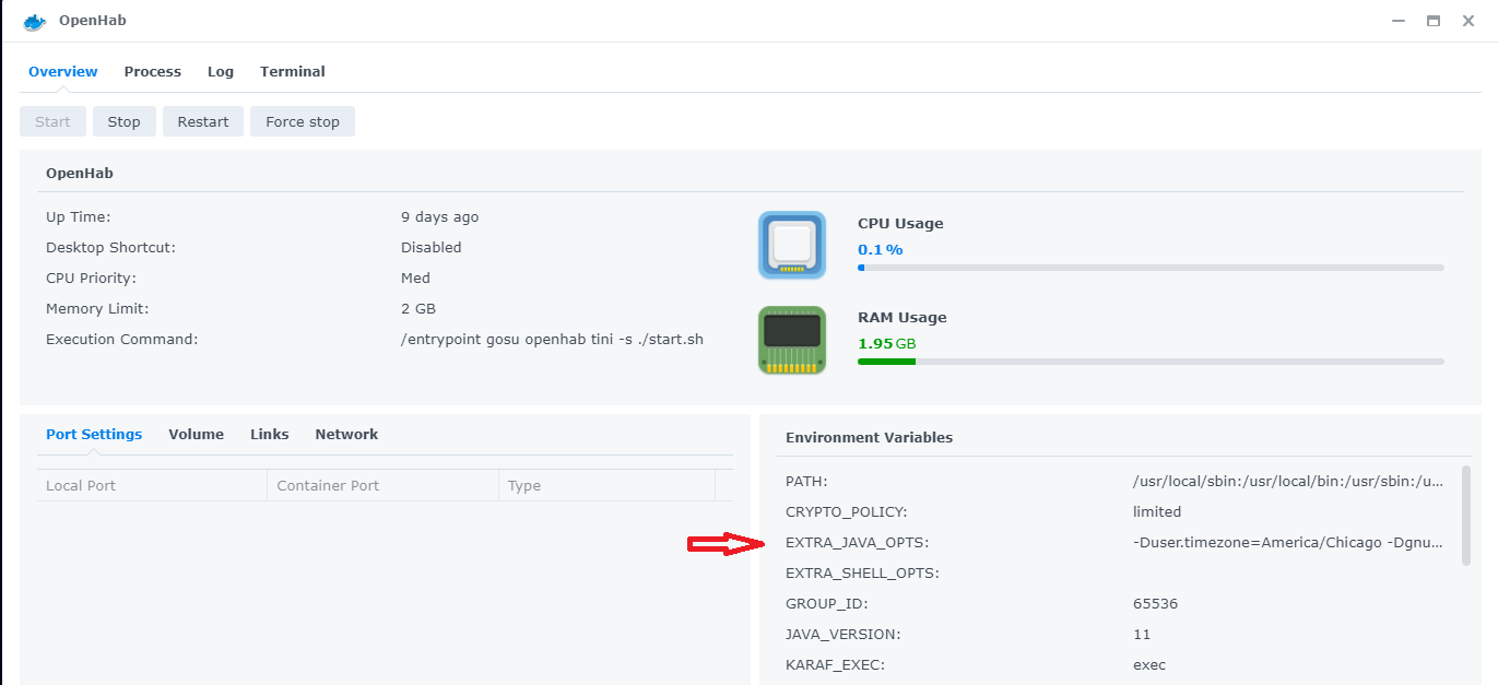

To set the time zone add your timezone to the EXTRA_JAVA_OPTS parameter in the environments section of the Docker config. For me it is -Duser.timezone=America/Chicago
Thank you very much! This helped. (I stopped and edited the environment then restarted the container for this. Don’t know if that was necessary, just in case someone has a similar problem)
