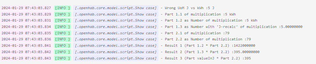

logInfo("Show case", "Wrong UoM J vs kWh :{}", SomeValueInJ.state)
logInfo("Show case", "Part 1.1 of multiplication :{}", SomeValueInkWh.state)
logInfo("Show case", "Part 1.2 as Number of multiplication :{}", SomeValueInkWh.state as Number)
logInfo("Show case", "Part 1.3 as Number with 'J-recalc' of multiplication :{}", SomeValueInkWh.state as Number/3600000) // 3.600J * 1000
logInfo("Show case", "Part 2.1 of multiplication :{}", weatherActClouds.state)
logInfo("Show case", "Part 2.2 as Number of multiplication :{}", weatherActClouds.state as Number)
val Number result1 = (SomeValueInkWh.state as Number) * (weatherActClouds.state as Number)
val Number result2 = (SomeValueInkWh.state as Number/3600000) * (weatherActClouds.state as Number)
logInfo("Show case", "Result 1 (Part 1.2 * Part 2.2) :{}", result1)
logInfo("Show case", "Result 2 (Part 1.3 * Part 2.2) :{}", result2)
The result in the log is as follows:
2024-01-28 20:51:13.426 [INFO ] [.openhab.core.model.script.Show case] - Wrong UoM J vs kWh :5 kWh
2024-01-28 20:51:13.430 [INFO ] [.openhab.core.model.script.Show case] - Part 1.1 of multiplication :5 kWh
2024-01-28 20:51:13.433 [INFO ] [.openhab.core.model.script.Show case] - Part 1.2 as Number of multiplication :5 kWh
2024-01-28 20:51:13.439 [INFO ] [.openhab.core.model.script.Show case] - Part 1.3 as Number with 'J-recalc' of multiplication :5.00000000
2024-01-28 20:51:13.442 [INFO ] [.openhab.core.model.script.Show case] - Part 2.1 of multiplication :0.05
2024-01-28 20:51:13.445 [INFO ] [.openhab.core.model.script.Show case] - Part 2.2 as Number of multiplication :0.05
2024-01-28 20:51:13.457 [INFO ] [.openhab.core.model.script.Show case] - Result 1 (Part 1.2 * Part 2.2) :900000.00
2024-01-28 20:51:13.459 [INFO ] [.openhab.core.model.script.Show case] - Result 2 (Part 1.3 * Part 2.2) :0.2500000000
