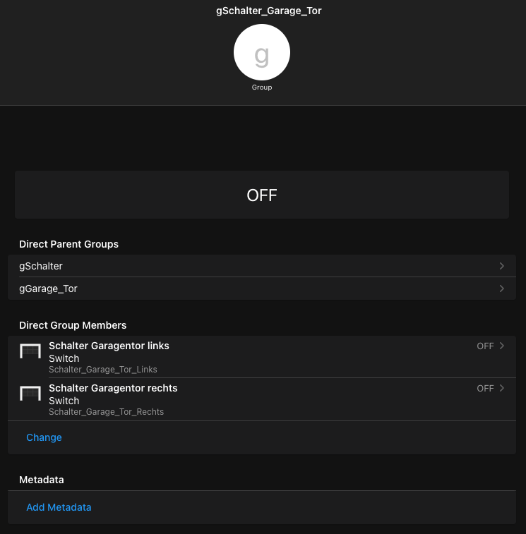

2021-07-27 22:35:52.045 [INFO ] [hab.event.GroupItemStateChangedEvent] - Item 'gSchalter_Garage_Tor' changed from OFF to UNDEF through Schalter_Garage_Tor_Rechts

Something weird about your Group; with no aggregation function defined, it should not have been OFF to begin with. Think there’s some kind of default Equality function though.
Note, if you are doing development, members added to Groups after the rule has been loaded will not trigger it. The list of targets is built from membership at rule load time.
Editing the rules file refreshes the trigger list.
You didn’t mention your full OH version, so may also need to be aware of this - any Item edit losing rule trigger link
