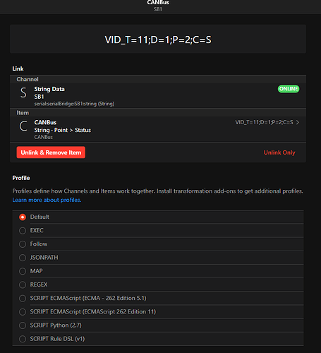

I have a rule I wrote with Rule DSL and I want to rewrite it with JS.
But in my searches in the forum, I could not find an example of receiving data from the serial port or a relationship for a similar structure.
I want to take the information from the serial port into the Script and divide it into parts and process it.

I need help on how to convert the following part. I have no idea for a starting point at the moment, unfortunately. Despite reading a lot of documents and messages, it has become more and more complicated.
Item CANBus received update // your condition here
var String CANBusData = CANBus.state.toString
if( CANBusData.startsWith("VID_T")){
val parts = CANBusData.split(";")
var dTYPE = Integer::parseInt(parts.get(0).split("=").get(1)) as Number
var dID = Integer::parseInt(parts.get(1).split("=").get(1)) as Number
var pID = Integer::parseInt(parts.get(2).split("=").get(1)) as Number
val String cID = (parts.get(3).split("=").get(1))
if ((cID == "S") || (cID == "L" )) {
val name = ScriptServiceUtil.getItemRegistry.getItem("I_"+ dID + "_" + pID + "_" + cID )
if (Log_Flag == 1) {
logInfo("CANBus", ">>>> String : {}", parts)
logInfo("CANBus", ">>>> CANBUS) Input.Device.Type : {}", dTYPE)
logInfo("CANBus", ">>>> CANBUS) Input.Device.ID : {}", dID)
logInfo("CANBus", ">>>> CANBUS) Input.Port.ID : {}", pID)
logInfo("CANBus", ">>>> CANBUS) Input.Command.ID : {}", cID)
logInfo("CANBus", ">>>> CANBUS) Item.Name : {}", name)
logInfo("CANBus", ">>>> CANBUS) Item.Type : {}", name.getType)
//logInfo("CANBus", ">>>> CANBUS) Item.AcceptedCommandTypes : '{}'", name.getAcceptedCommandTypes)
//logInfo("CANBus", ">>>> CANBUS) Item.getAcceptedDataTypes : '{}'", name.getAcceptedDataTypes)
logInfo("CANBus", ">>>> CANBUS) Item.State : {}", name.getState)
Thank you.
