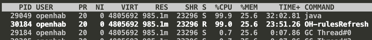

My questions to troubleshoot would be:
  • do you have processes (java ?) running at 100% CPU ?
  • can you run top -H -p $(pgrep -x java) to see what is using up time ? Does it look like the screenshot below ?
I like the :slight_smile: from @vanja asking if you use a cron that could be erroneous ?

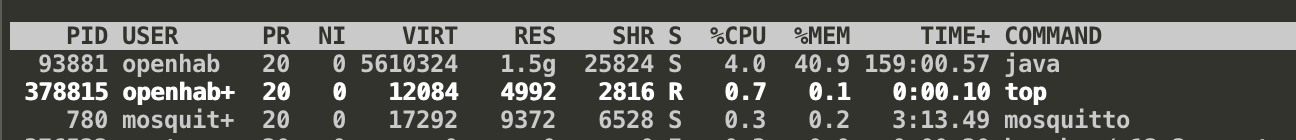

If by large Java you mean the high CPU, what you see on the screenshot is totally NOT normal and untypical.
Now that I fixed the issue, it looks much quieter:
Inside the Java process, everything is mostly sleeping as it should now:
I mean the VIRT column which is the virtual process size. 5.6G ! Even the in-memory fraction (RES column) is 1.5G.
