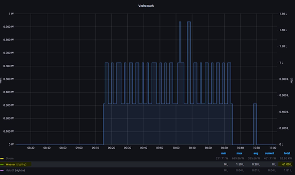

Today I noticed that our toilet cistern is leaking and it wasted ~60l for a short period of time, visible in Grafana:
I would like to have a rule which sends me a notification if the consumption value is adding up (changing) frequently for a certain amount of time. How can I do this? Here are my two items to check the water flow and a proxy item to see when water was consumed the last time:
