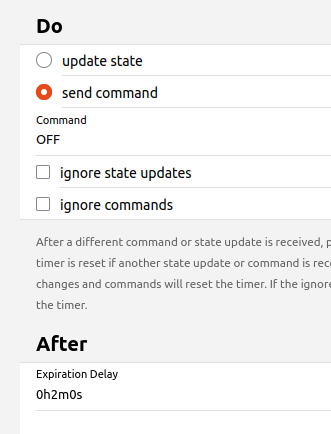

You could remove the timer and use the expire metadata thingy. That would be the simplest solution I think.

Yes I use the expire all the time.

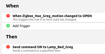

I have the expire on the light and a rule that says if motion then turn on the light.
If there is motion before the light expires then the expire time gets reset automatically.
No need for time rule I just let expire take care of it.
Rule:
Expire:
Ah yes, if you set expire on the light, it will turn off even when you wanted to turn it on longer by manually turning it on (e.g. a switch on the wall).
