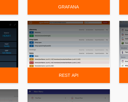

In the paperUI install the REST API docs
Addons - Misc - Rest documentation
Then on your dashboard you should get a new tile:

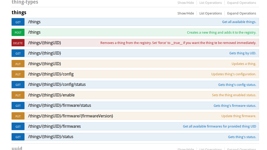

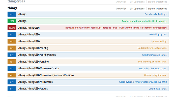

First one
Get all available things
Try it out!
You will get a json with all available things in there

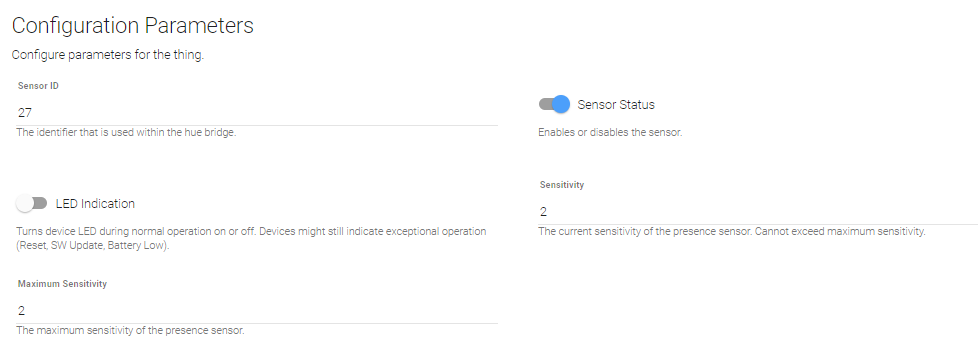

looking in paper ui the values are not there either
Looking at the poll results from the bridge i cant see a value there either maby this is only configurable on the hue app on the phone

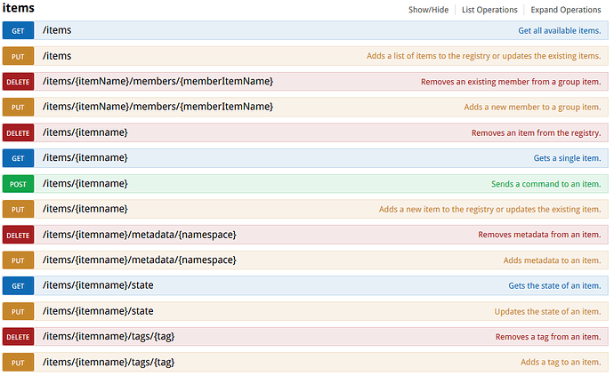

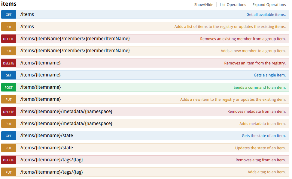

this will be your new best friend!
POST is like sendCommand and PUT is like sendUpdate or postUpdate whatever it is.
GET is good for viewing current state. You’ll figure it all out.
