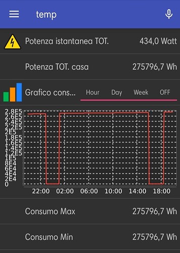

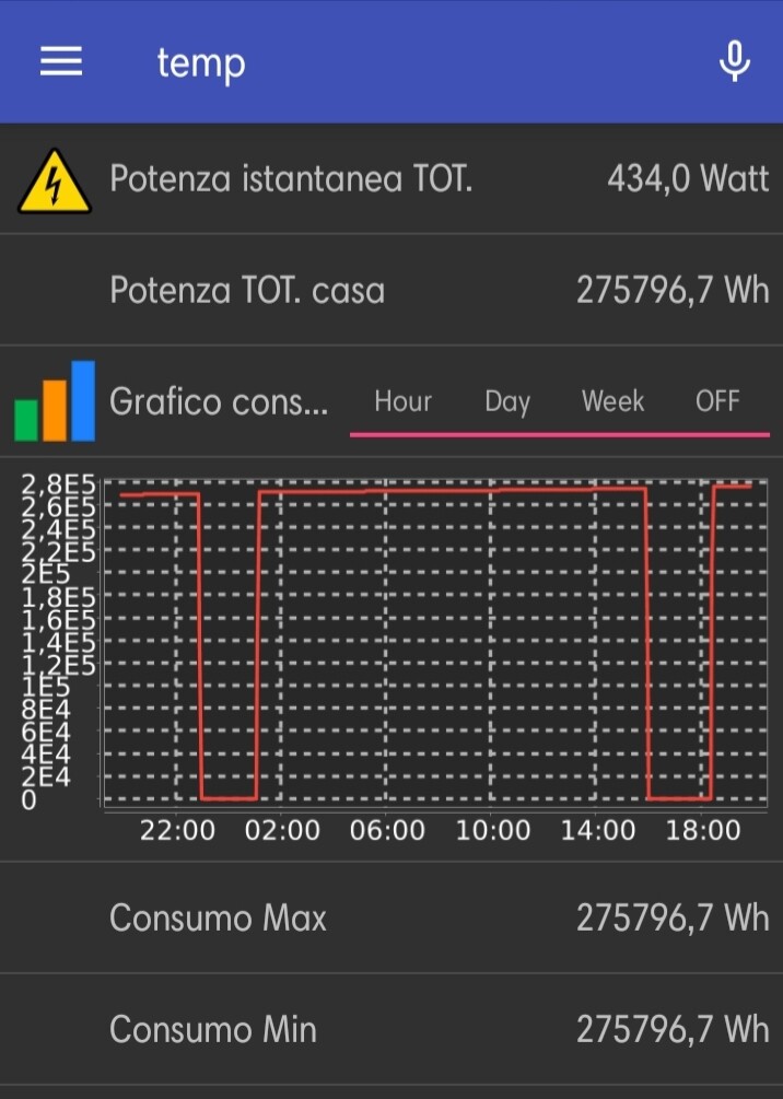

This is the result…
Screenshot_20191015-195616_openHAB
The minimum value it’s still wrong. I restarted OH for see the result.
Changing the Rule isn’t going to change past data already stored in the database. It will only prevent new 0s from being stored in the database. You need to manually remove the 0s from the data already in the database.
