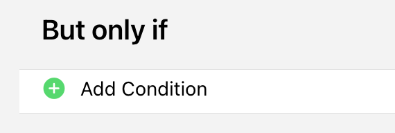

A better approach would be to put that overarching if statement into a Script Condition. That would simplify the code a bit.
Another approach that a lot of people have used successfully is to create a system startlevel rule to simply disable the rules. Then have another rule that triggers when your Item changes to ON to reenable those rules. That way you’ve centralized this startup logic rather than needing to repeat it all over the place in your rules.
My biggest concern with this specific implementation is that you basically have to add the same logic to every rule (or at least every time sensitive rule). If you can centralize that somehow or, at least pull it out into the condition which you can copy and paste that would be better I think for long term maintenance and legibility.
Off-topic comment; better/faster hardware can bring new timing races that a plodding Pi user never sees.
You still get startup chaos, but taking a different form. For example, system services like rule engine may become available well before external services. As noted already, carefully thinking through rule dependencies is often all that is needed.
Do you mean like call a script script from each rule that that checks for the SystemStartupState and exits the rule early? Doesn’t look like return; works for that anymore. That’d just be too easy..
Hmm
 I guess maybe I incorrectly assumed that a disabled rule wouldn’t be executed, and therefore not compiled or pulled into memory. Thus it would still run slow the first time it actually executed when enabled. Is that not the case? When I disable a rule in the UI and click run, nothing happens. I enable it, it runs slow, and run a second time its fast.

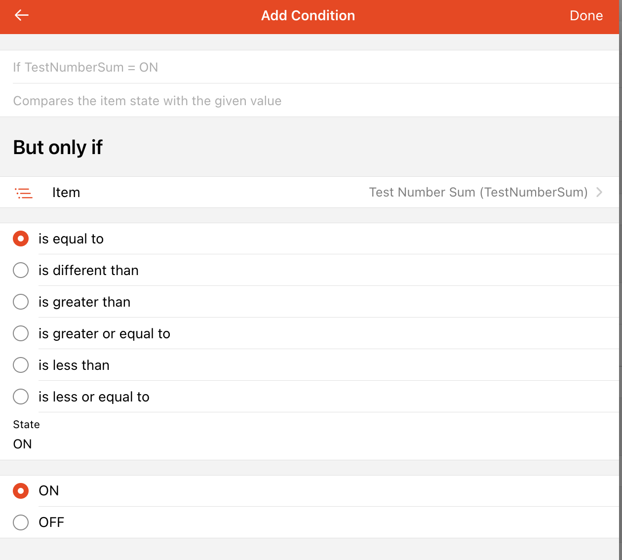

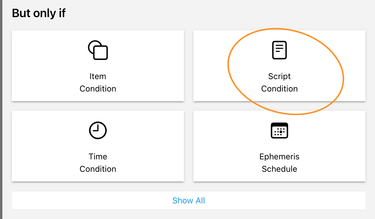

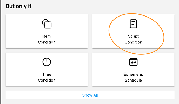

No, I mean use a script condition in the “But only if” part of the rule.
The whole point of Conditions is to define what states must be true before the rule is allowed to run. Though in this case, all you’d really need is an Item Condition so the rule only runs when the SystemStartedStatus Item is ON.
If you had more complicated conditions or wanted to log or something, you can write a script condition.
If it was complicated enough, you could even put that into a library called from the script condition.
But this case isn’t that complicated. All you need is the simple Item Condition on the rules that need to be suppressed while OH is starting up.

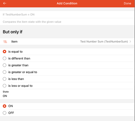

I guess I hadn’t considered you meant those conditions as you pointed out:
Adding a condition based on my SystemStartedStatus item would prevent the rules from running at startup, which would leave them uncompiled and still result in a slow first run. So, while the approach would be more maintainable, it could never actually achieve the goal.
Exactly, that’s what I’m doing to trigger my rules at startup. Their current conditions prevent them from otherwise running at startup, which is why I don’t have to disable them. Using a rule to trigger the other rules is also what enforced the execution of the rules after that startup rule first sets SystemStartedStatus OFF.
I hear your point about maintainability, I would certainly prefer not having to have the extra statement embedded directly in the script of each of the rules. I’m just not currently aware of another way to get the rule compiled and into memory without doing so. Do you have any other suggestions?
Might have to determine that by experiment; does or does not the rule “framework” for trigger and condition also pullin the scripted action section? Bearing in mind a condition may itself be scripted, it might just pull in the whole show anyway on any trigger.
Confirmed with testing that it does not appear to complie the action unless the rule is triggered with conditions met. I setup a simple example and tried with a item condition then with a script condition. I got the same slow first execution after startup complete both times.
