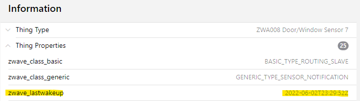

You can run the .sh script directly on your OH Server (if it is Linux :slight_smile: )
There you can see the hole output and if it is even working. You should get the same output as in the API Explorer. There you should see “zwave_lastwakeup”.
You should also see the value in the UI in the Things properties:
I’m running OH 3.2 on openhabian.
