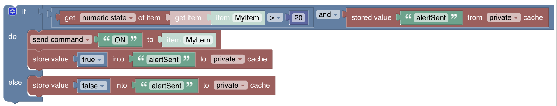

Or, because I strongly recommend against new development of rules in Rules DSL, in Blockly:

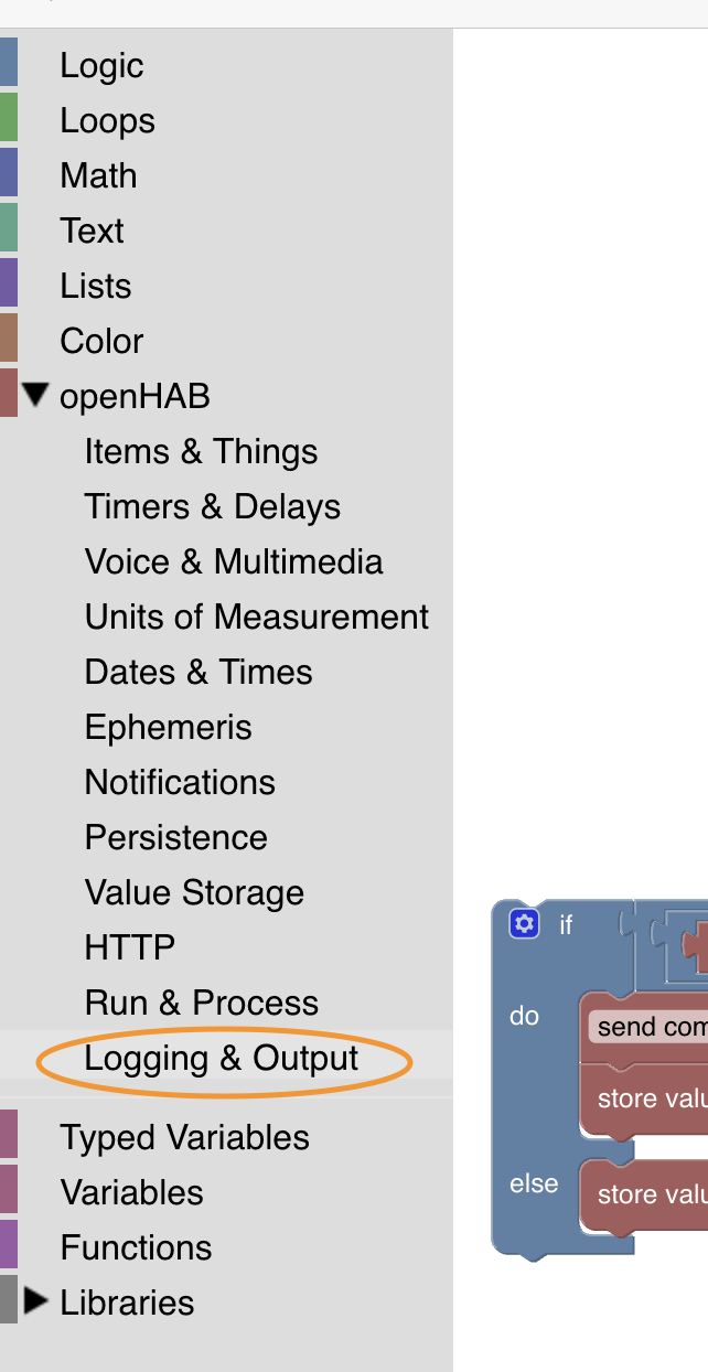

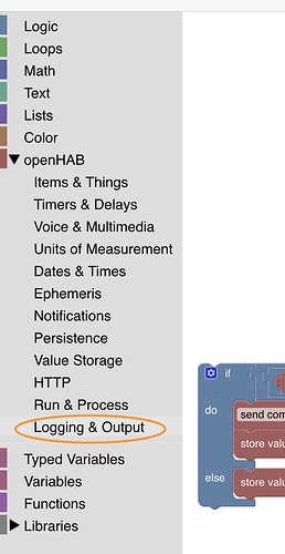

If you can not or don’t want to use the reference docs as your first place to look for basic questions like these I cannot stress strongly enough that you will be much better off using Blockly where the answers to such questions are right there in front of you:
When a statement is logged it goes to openhab.log. If you’ve installed openHABian you can see the logs through Frontail. Otherwise you need to look at the files themselves.

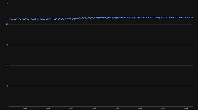

The item level stated updates from 21.5 to 21.6 and so on.
But the item “Int_level_max” still stated “NULL” in the items list

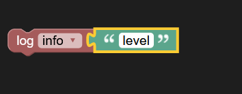

OK, that’s close to what you want. But that line is just going to log out the word “level”. You want to see what the state of the Item level is.
I’m assuming you know to replace “MyItem” with your level Item. Just click it and you will see a list of all your Items to select from.
You can build of complicated strings to log using the
block. Click the gear and add an “Item” for each part of the String you want to create.
