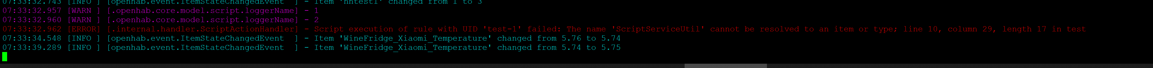

You can see above that debug 3 and 4 do not show.
All my rules check to see if the optional item exists, if not, they exit cleanly (return; in the exception) but now that does not happen and the log fills with errors.

I had to way zoom in on my phone (please don’t post screenshots of text, you clearly already know how to use code fences, use them for logs as well). The error isn’t that the Item doesn’t exist, the problem reported is ScriptServiceUtil doesn’t exist. Did you import it? You don’t get it by default without importing it.
