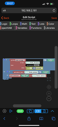

I want my roller shutter goes up if avarage wind speed is greater then a value.
So I persist my wind speed every second modyfing rrd4j.persist accordingly
I create a rule with blocky and I get the state of my wind speed item (only if it is updated)since now minus 5 seconds and if wind average is above my trigger value my roller goes up.
The problem is that it works only with the expression ‘get the state of my item since now minus 5 seconds and I would like to get the average with ‘since now plus my seconds’ it would be better but it won’t work.

    blockSource: GTEaverageSinceVento_Terrazzadefaultrrd4jminusSeconds5minusSeconds5514LTETende_camere70sendCommand70100Tende_camere
    type: application/javascript
    script: >
    if
    ((items.getItem(‘Vento_Terrazza’).history.averageSince(time.ZonedDateTime.now().minusSeconds(5),
    ‘rrd4j’)) >= ‘14’) {
    if (items.getItem(‘Tende_camere’).state <= ‘70’) {
    items.getItem(‘Tende_camere’).sendCommand(‘100’);
    type: script.ScriptAction

I tried with influxdb as well with same strategy but with no succes. Rule is triggered only if I get the avarage in the past.
I would like my terrace rollers go up when the wind intensity it lasts enough, at least 7/10 seconds.

As it is build the rule now the rollers go up immediately as the wind starts because the average ‘since now minus seconds’ is always higher than my trigger.
The sensor is updated every change it would be even every second and I woul like to get the average once the sensor is updatedfor the 10 seconds after.
Doesn’t work means that if change in the rule with the avarage ‘since now plus x seconds’ nothing happen and my rollers don’t go up at all.
At the end in this way or it go up immediately once the sensor is updated (cause the avarage is obviously higher)or they don’t go up at all.

And what is the command for action in case of wind too high ?
Thank you
Thank you Rich.
For sure the problem is over my little experience and scripting knowledge.
you stated you have a wind speed item if you use a on change event then it will fire the rule.
if the wind speed is greater then whatever you decide is a wind speed too high value it will start sampling the wind speed item every 1 sec for 10 samples. if you create a generic item (switch) that is on off (1 is on 0 is off ) and set a condition on your rule to not run again if the switch is on it will not fire the rule with inline script again if the wind speed onchanged event occurs any more (even if it changed 10 times during those 10 seconds) we only want the rule to run one time during that 10 second interval of sampling. till all 10 sample values are collected and averaged. The wind speed may continue changing during that 10 seconds and your wind speed values may be different for each sample but since each sample is a get of the current wind speed item the script does not care about more on change events till 10 samples of windspeed are collected. once the 10 samples are complete it will set the (generic switch back to off ) and it resets for next event cycle. The reason I chose to set 10 separate items to collect is if during that 10 seconds if one value does go to 0 then the math will still add value of 0 plus any other number values so the math function remains valid. I did average after 10 samples too avoid a 0 value because well average is a division math function and would blow up because you cannot divide by zero. since we know the first sample will be some number value greater then 0 because you would not want it to trigger for “no wind” then we know the final sum no matter what will be some thing more then 0 and the average will work fine.
The command for action would be what every item you have that “closes the roll shutter”.
edit: Also reason I say used on changed is if you have a windspeed that is fluctuating between .2 and .8 and you wind_too_high is set at .9 then you will check for each change to see if wind speed is picking up. but not start collecting samples till your current_windspeed is equal to or greater then your_wind_too_high value. this may cause the rule to kick off more often but since very first check is the compare it will exit very quickly and should not be too expensive. You should also add another condition to only allow the rule to run if the roller shutter is in open state as well. This would prevent the rule from running anytime roller shutter is already closed.
