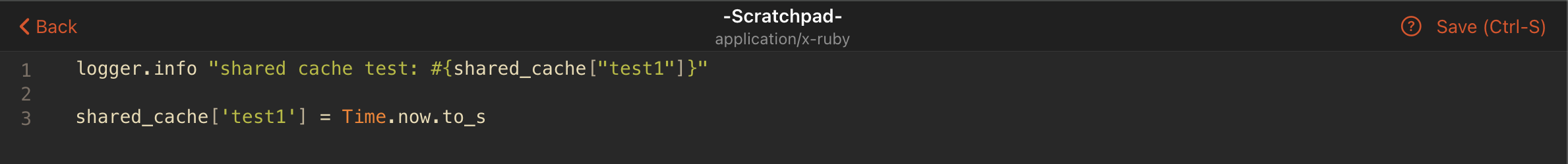

Here I do the test for you:
in Main UI Settings → Scripts I use the scratchpad script, in jruby
logger.info "shared cache test: #{shared_cache["test1"]}"
shared_cache['test1'] = Time.now.to_s
Resulting log:
  • When I saved the script, you’ll see Rule 'scratchpad' has been updated which also means the cache gets removed since it’s the only script accessing the cache key.
  • The first one is obviously empty since it hasn’t been assigned yet
  • Subsequent executions show that it retained the previous value
13:27:56.160 [INFO ] [openhab.event.RuleUpdatedEvent       ] - Rule 'scratchpad' has been updated.
13:28:07.245 [INFO ] [tion.jrubyscripting.script.scratchpad] - shared cache test:
13:28:12.551 [INFO ] [tion.jrubyscripting.script.scratchpad] - shared cache test: 2025-10-05 13:28:07 +1000
13:28:17.133 [INFO ] [tion.jrubyscripting.script.scratchpad] - shared cache test: 2025-10-05 13:28:12 +1000
13:28:23.491 [INFO ] [openhab.event.RuleUpdatedEvent       ] - Rule 'scratchpad' has been updated.
13:28:26.454 [INFO ] [tion.jrubyscripting.script.scratchpad] - shared cache test:

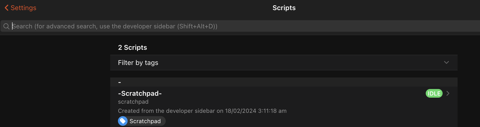

How do you “unload” this script so that the cache entry is deleted? By deleting it?
As I said above - when you saved the script (any script - rule, transformation, scene, etc), the old one is unloaded first, then the new version is loaded.
Either you press Cmd+S / Ctrl+S or click “Save” in the top righthand corner.
But that is a manual operation. Do you mean that users should open and resave the scripts to “clean up” the cache? My production system runs for months at a time, some very old value might not be very relevant. I don’t use any cached values today, so I’m not sure exactly when they are useful, but I assume that they are most useful if the previous value was stored as part of some ongoing process that don’t span over months. Which is why I thought that a TTL might have some use cases to prevent using stale information.

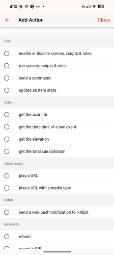

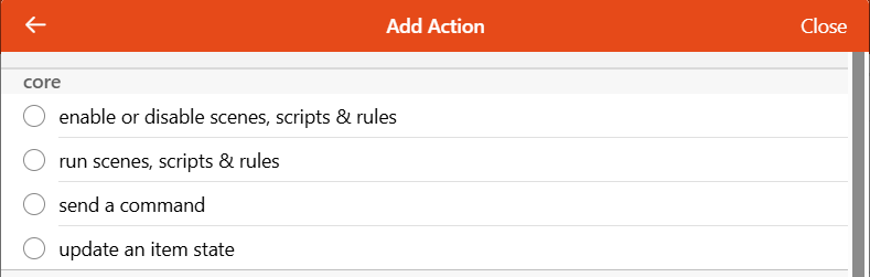

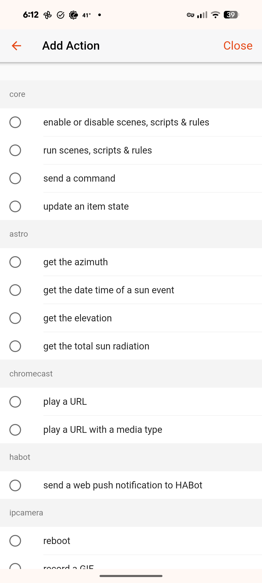

When using the UI to create an Action, I do see that ThingActions show up as choices, along with a few other “standard actions” under “core”:
Most of the “script actions” don’t show up there though, so the relation between them is still quite fuzzy to me.
