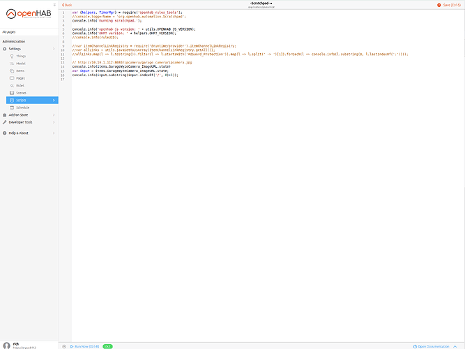

That’s because I can’t create a full YAML version of a Script in MainUI. Even Scenes have a code tab but Scripts do not.
I could handwritten the YAML or pulled the Script from the JSONDB. But it’s just an empty rule consisting of just a single Script Action. But I don’t feel compelled to do that to compensate for a limitation in MainUI (which I think I opened an issue for many years ago) which doesn’t actually add any additional information.
