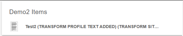

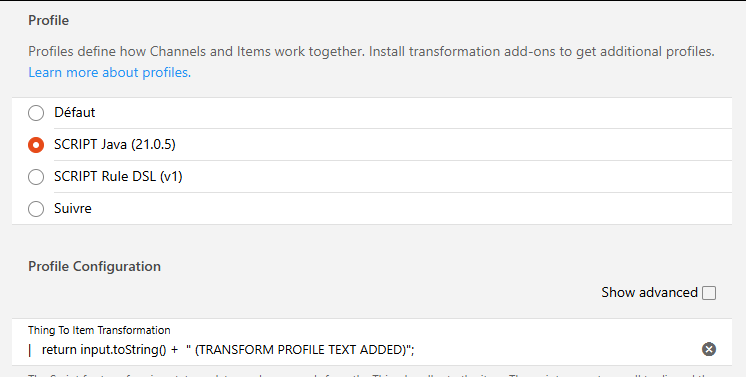

About transformations, I have an items/x.items with content String x, I set its value with curl -X POST --header "Content-Type: text/plain" --header "Accept: application/json" -d "BRUM" "http://127.0.0.1:8080/rest/items/x" and I have a sitemaps/cd.sitemap
sitemap cd label="B3" {
  Text item=x label="DSL    [DSL(|    return input +  \" DSL\";   ):%s]"
  Text item=x label="GROOVY [GROOVY(| return input +  \" GROOVY\";):%s]"
  Text item=x label="JAVA   [JAVA(|   return input.toString() +  \" JAVA\";):%s]"
openhab.log logs: 2025-09-03 18:26:47.378 [WARN ] [ui.internal.items.ItemUIRegistryImpl] - Failed transforming the value 'BRUM' with pattern 'JAVA(| return input.toString() + " JAVA" ;):BRUM': Failed to execute script. It does not help, when I remove .toString(). How are (inline) transformations supposed to be used? The DLS and GROOVY transforms do what they are supposed to do.

Frame label="Demo2 Items" {
    Text item=Conversation_with_XXXX_Message_Received label="[JAVA(|   return input +  \" (TRANSFORM SITEMAP ADDED)\";):%s]"
And in a transformation profile in the GUI
And the result is
So it should be totally OK with the way you are doing it.
