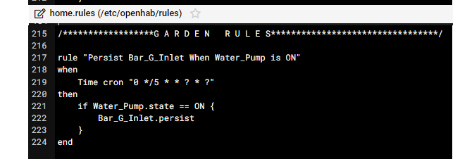

rule "Persist Bar_G_Inlet When Water_Pump is ON"
    Time cron "0 */5 * * ? * ?"
    if Water_Pump.state == ON {
        Bar_G_Inlet.persist
This is what you need as @jimtng mentioned.

This is the code in the Rule file

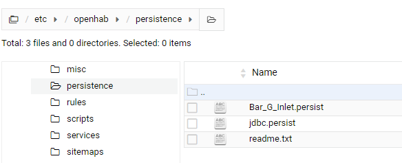

The file Bar_G_Inlet.persist would never be taken into account the files persist have to be named based on the database used
Recap. The whole point of persistance is to define the strategies for when and under what condition item are stored in a database of choosing. Now your request demand that an item state is stored every 5 minutes while another item state is on Wich is what the rule is doing meaning you don’t need to define any strategy for persistance for that item you want to persist.
The rules goes in the folder rules with a .rules file extension
The persistance folder should not have anything in it related to that item as a strategy. Also you should have defined a default database for persistance in the webui or openhab conf file.

Perfect that is all you need and make sure the jdbc.persist doesn’t persist your Bar_G_Inlet.

I don’t see any obvious problem also delete the Bar_G_Inlet.persist. What now you want filters but that will not help to only record when the pump is on ?
