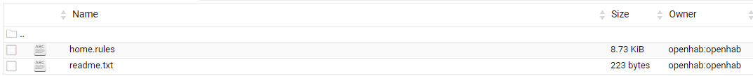

I created a file called bar.rules and pasted the code you gave there.
(rule “Persist Bar_G_Inlet When Water_Pump is ON”
Time cron “0 */5 * * ? * ?”
if Water_Pump.state == ON {
jdbc.persist
end)
