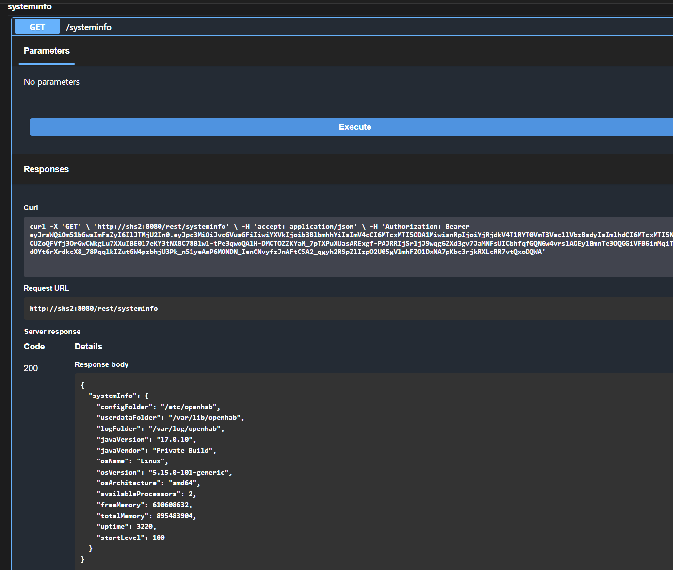

Have you checked that you reach startLevel 100. Think you need at least 80 for the Rule Engine to start.
Also check:
If Rules are empty and startLevel not 100, do a forum search for hints.

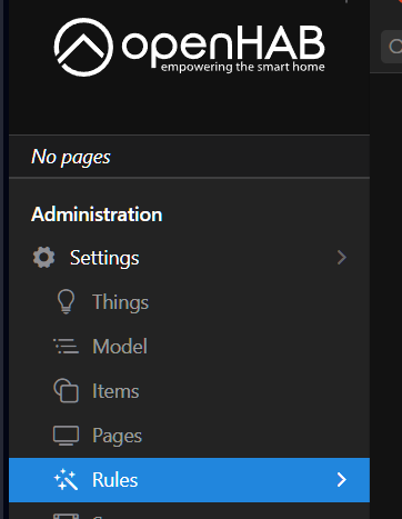

Screenshot
Yes, but I was thinking of the Rules tab in the WEB UI, usually at http://:8080
