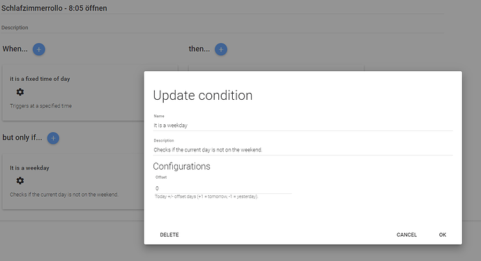

What am I doing wrong? If I enter the days of the week, the rule no longer works! Thank you for your help
2019-12-19 11:48:37.726 [ERROR] [e.automation.internal.RuleEngineImpl] - Failed to execute rule ‘7fe69863-034f-4932-8417-312dce0235e0’ with status ‘UNINITIALIZED’
2019-12-19 11:49:16.797 [.event.RuleStatusInfoEvent] - 7fe69863-034f-4932-8417-312dce0235e0 updated: UNINITIALIZED (HANDLER_INITIALIZING_ERROR): Getting handler ‘ephemeris.WeekdayCondition’ for module ‘3’ failed: Config parameter ‘offset’ is missing in the configuration of module ‘3’.

This is not clear. Where are you attempting to add the days of the week? In the Paper UI system configuration for Ephemeris or one of the configuration files. Do you have any exceptions in the log for Ephemeris after a restart?
Exceptions after reboot:
2019-12-19 13:07:58.457 [.event.RuleStatusInfoEvent] - 7fe69863-034f-4932-8417-312dce0235e0 updated: UNINITIALIZED (HANDLER_INITIALIZING_ERROR): Getting handler ‘ephemeris.WeekdayCondition’ for module ‘5’ failed: Config parameter ‘offset’ is missing in the configuration of module ‘5’.

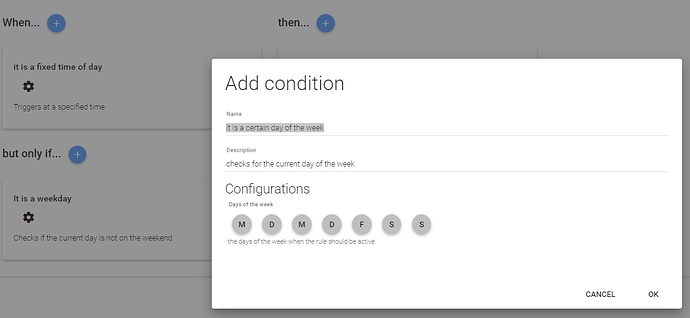

I try to change it in Paper UI under Emphemeris. But I can’t customize it. it always says “SATURDAY, SUNDAY”
As a rule on “it is a certain day of the week” I can’t choose days either.

Note that Ephemeris is independent of the Day of the week conditional clause. It only applies to:
The inability to select days for “It is a certain day of the week” is a long since reported bug with PaperUI.
